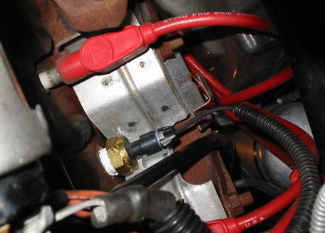

I have the Jet-Fan Switch dual 12" Perma Cool electric fans and a 180* thermostat and my LO3 305 was still running hot in the summer heat. On a 105* day idling in stop and go traffic, the temperature gauge went to 260* and cooled down to 240* once I started to move. I have since switched to a 195* thermostat and the engine operates at a more consistant temperature (around 195* in 70* weather).

Do you know if they make one for the 350? Probably the same kit right? I hate watching my temp creep up when I'm stopped as well. Is the sensor that thing that's on the block on the passenger side right underneath the head? Thanks for any info! Matt
Old Mar 21, 2003 | 12:58 AM
MdFormula350's Avatar
Joined: Nov 2001
Posts: 11,634
From: Maryland; USA
yeah the fan switch is in between the 6 and 8 cyclinders passengers side...
