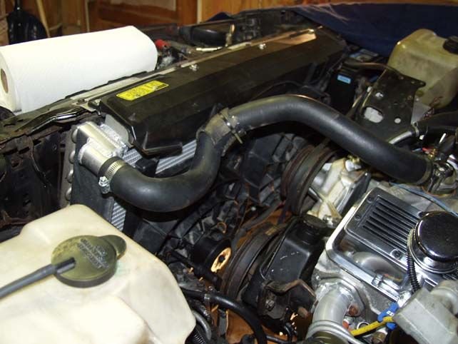

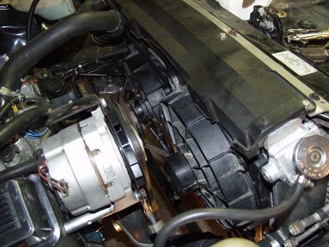

Many of you replied to my post titled Air Dam & Mechanical vs. Electric Fan and were very helpful to me, I decided to install a dual fan/shroud setup off an LT-1 powered F-Body. I finally completed this installation yesterday, it was more challenging than I thought it would be, but I'm happy with the end results, although I haven't road tested the car yet. Here are some pictures of the installation (I'll only post a few here so the dial-uppers don't die, the rest can be found here
Here's the back of the shroud, I had to remove A LOT of material to allow the shroud to fit closely to the radiator and not interfere with the power steering box, etc. I removed extra material that stuck out on the back of the shroud.
This pic is a little blurry, but its point is to show where I had to remove material from the shrouding on the fan itself, you can see the area that I ground down, this was to clear the power steering box
Here's the shroud in place
Here's the upper shroud from my single fan setup, I had to cut quite a bit off of it so that it would clear the higher of the two fans but still function to hold the radiator in place
Here's a pic of the fans installed, viewing from the top
I'll stop there, but there was a clearance issue with one of the power steering hoses, and I was able to bend it out of the way, if you go to the link above there are also pictures of the installed fans from underneath. Anyway, that's it, and let me know what you think!!!!!!!

Thanks, glad you like it, it works quite well too If memory serves me correctly I paid about $80 for it, shipped to me, that included both fans, the shroud, and the wiring pigtails to the fans. I got it off ebay and I think I did all right, considering that just one aftermarket fan would have cost what I paid for the whole setup, and I've been told that the LT-1 fans flow BETTER than any of the aftermarket setups. Anyway, hope this helped, and any more questions/comments, etc. are very much welcome!!

Well, I've driven the car some now, and going down the road it runs about 190-197 (digital guage, reading out of the intake manifold, and I've got a 180 t-stat). Around town the hottest it's gotten was 211, today when it was almost 100 degrees out. It hit 211 as I came to a stoplight, and as I waited for the light I watched the temp drop back down again. In any case I think the dual fans have taken care of my problems w/ overheating Just thought I'd let you all know!

WaybackMachine to the rescue here. Found this old thread, and these three images were archived at least. Was going to do this swap as well and wanted to see if I could find the pictures. Uploaded to the board, so no third-party hosting.

Nice! I think it should be noted though that Those are the LT1 fans which have the removeable assemblies. the LS fans are one whole unit. and are a tad bit thinnner but overall more less the same!
