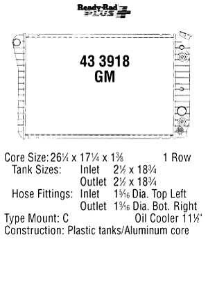

i would spend the extra 50 bucks at like advance auto and get a direct fit aluminum one, because that will have the correct size and capacity, and the same for the tranny cooler inside.

I have 5 montes. The alum. f-body one cools better, and it has the heater hose fitting on the RH side.
