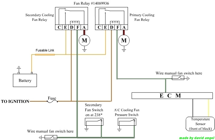

Ok,
Yes its a common problem and yes I tried the search function but I didn't find any relevant info.
Car: 88 GTA stock cooling setup.
Fans didn't work anymore from one day to the other. Won't run with AC on, won't run with ALDL on.
All fuses are fine.
Checked the relays for the fans. Result:
Hot-wired both relays on pin A and E, fans won't come on (used the diagrams I found here). Relays had 12V to ground, tho. On one relay, the pins D and F had current as well. Interchanged the relays.. Still no fans.
I wouldn't be happy about cutting any cables for testing.. And seeing it was crap what I did.
On the diagram below, seen from the electrical aspect, the fuses are set wrong. But is this the explanation for why I still have 12V at the fusible link with the fuse pulled?
Or are the relays simply shot? Howsoever this could happen in the blink of an eye.
Thanks for any input.

I can give you the wiring schematics for an 89 camaro's cooling fans that might help you if you want them.

Hello Flameredroc,
Here are those schematics, hope they help you.

The schematics helped considerably, but which relay(s) under the hood are for the fans?????

There should be one next to the radiator and one on the fender next to the coolant tank.

Thanx, that helped alot!!!!
Now I can test the power flow according to the above charts.
