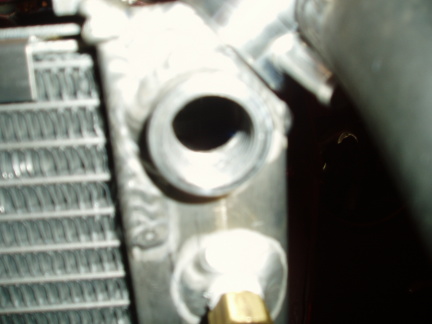

what in the hell did you guys do with this part? i can't find the proper fitting anywhere as i've spent all day going to every shop possible from hardware to autoparts with no luck at all.

Gotta love stupid clerks....

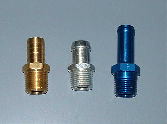

You need a 1/2 NPT-to-3/4" hose barb fitting. (or 1/2NPT to whatever size heater hose you're using...)
Any decent hardware store should have one in brass.
Any decent auto parts store should have them in steel. (i.e. SBC water pump hose fittings, often can be found in the "Help" section in either 3/4 or 5/8 hose size.)
Earls, or any of the performance or aircraft plumbing vendors, should have them in aluminum. IMHO, this is the best choice, not only for the light weight, but it expands at the same rate as the radiator, which makes it less likely to leak. I doubt you'll find the aluminum ones locally, though.

Here's a picture of all three types I mentioned.

so as far as the size your talking about do you have one of these radiators and know that's what it is? it would make sense and i appreciate the insight all the same.
my problem was the whole measures out to what looks like 3/4" but a 3/4" brass fitting does not fit as it's too big, 1/2" seems too small??

I've had a Be Cool rad in my '83 for a few years now. Trust me, it'll be worth it once you get the last few details sorted out.
Pipe thread can be kind of confusing -- 1/2 NPT isn't 1/2" in diameter, it's more like .830" OD. The pic you posted of your rad looks exactly like mine, and I'm certain mine has 1/2 NPT threads.
The only thing I'm not positive about, is the stock return hose size. I'm pretty sure it's 3/4" hose on a stock TPI -- but my car wasn't originally TPI, and I've got things plumbed in my own way, which is why I wanted you to be sure to verify your hose diameter.
An option, if you can't find any hose fittings, would be to install a 1/2NPT pipe plug in the rad, and a rubber cap on the heater core, or another pipe plug in the intake manifold. That would get you by until you have time to locate a proper fitting.

Yeah I seem to remember that fitting being 1/2" NPT on my Be Cool. I ended up just plugging it since I'm running a v-belt setup and have the heater hose connected to the water pump instead of the radiator. I did get some 1/2" NPT nipples that I used in the water pump and intake manifold and I found them quite easily. That sucks that you can't find them around where you are. Like the others have said though, once you get through the aggrivation of the install you'll be happy with the radiator. Good luck!!

well the id of the hose measures 3/4" on the inside so you think a 1/2" npt with 3/4" nipple will work? just seems so small but i'll try it....
