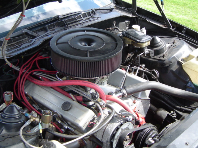

Thanks in advance for taking the time to read this. I recently bought a 91' Camaro RS with a 5.0 in it, the owned before me bypassed the heater core because it had a leak, when he bypassed it all he did was cut the hoses and put a stopper in the ends of them. I replaced the heater core, but I have no idea where I am suppost to run the hoses to. If any one could provide me with some info or pictures on what to do it would be greatly appreciated.

Here is how mine are running on my car. Not sure if this will help or not.
Have seen others having one hose going to the radiator and the other one to the intake.

Image attached
Here is an image showing the location of the heater hoses, I pulled it off another thread a few months ago.

I've routed my heater hoses in the same manner as JohnZ28.
