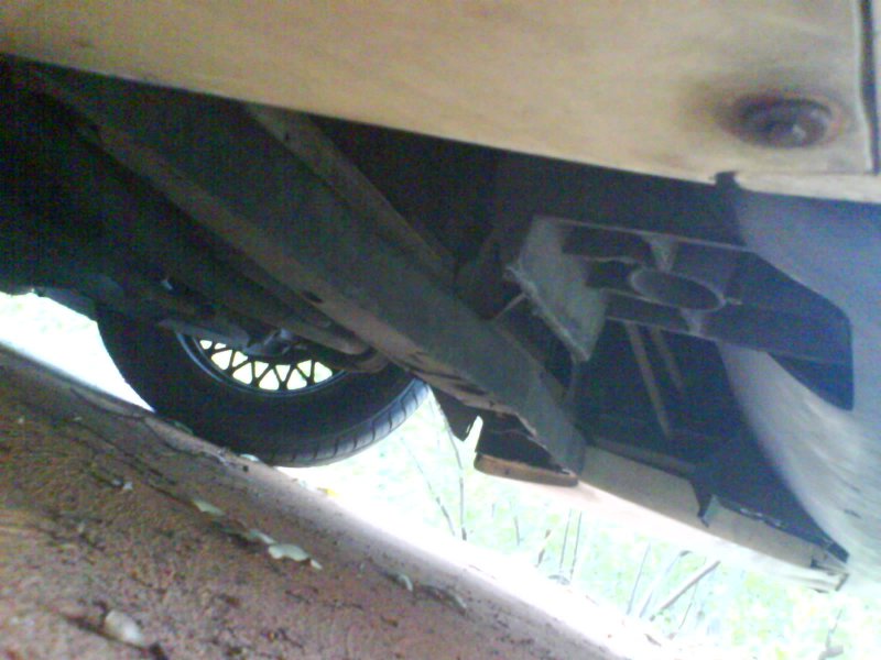

I've got an 88 trans am. The car is getting hot on the highway and I'm not sure if the air dam is good, broken, or not even there.
There unfortunately aren't many other 3rd gens running around down here, so I can't really check on someone else's car what it's meant to look like, and I've spent about an hour searching the forums & net with no luck.
If someone could have a look at the pic and tell me what they think, cheers
edit- actually, what are those plastic moulding/vent things at the front? One's right in the foreground of the pic.

So is mine completely missing (hopefully the pic is semi-clear with what's going on down there) ? Because I can't see anything down there that looks like the 3-piece air dam. There is a plastic thing that looks like the 1-piece.

Looks like you've got the old style but the three piece should bolt right in. It will look better and provide better cooling. I installed one on my 85 TA summer before last. If you install it I would recommend that you attach a brace between the three pieces. Maybe hard to explain, but I cut about a 3x3 piece from my old dam and let it span the gap between the new pieces, drilled two holes at each edge of the new dam pieces and used some of the extra fasteners to attach it behind the new pieces.

Ya, to me it looks like the whole bottom of the dam got cut off. It should be atleast 3 to 4 times longer than it is. I could be wrong though, I haven't seen a bird setup; but I am sure its the same.

Didn't realise this thread was still going. Thanks whoever posted the underbelly of the red car up there, that was what I had, bit of plastic that did nothing.
Got the 3-piece from the site above weeks ago, clipped right in. I have about 3 inches of ground clearance at the best of times, but the car is running cool again which is the main thing.
