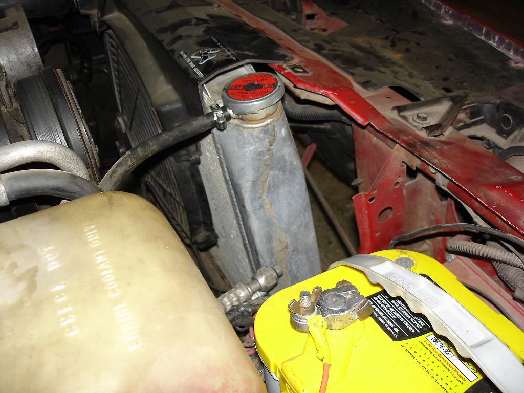

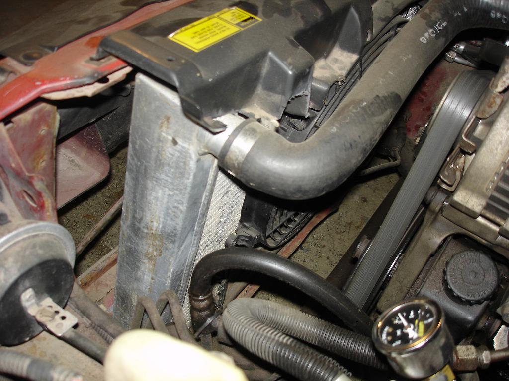

i do have an aftermarket electric radiator it does move alot of air. it is setup to turn on when i throw the a/c switch or when my temp gauge reads 230 degrees. i don't know if thats normal but it will climb higher than 230.
also in the pics the radiator that i installed is smaller in width than the factory. would that cause me to have cooling issues? as in the air moves around the radiator instead of through it?
It does heat up when stopped or when driving down a back road.

I think you should do whatever you can to make sure air isn't going around your radiator but is forced through it while you're driving. it's going to take the path of least resistance, so if you have giant gaping holes to either side of your radiator, next to nothing is going to go through it.
when you're sitting at a traffic light will your temperature still rise or is your radiator fan cooling it down while you're stopped for a bit? the gaping holes to either side of your radiator shouldn't be a problem when you're sitting still because the fan should be right up against it, almost forcing air to pull through it.
That is the first thing that came to my attention. Make some plastic "ramps" that make the air go through the radiator. Did the car over heat with the stock radiator in?
