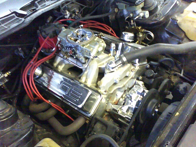

What you did when you installed that hose from the intake to the rad, is you put a DIRECT BYPASS of the radiator in place.
In other words, it is now possible for hot water to exit the top of the motor at the intake, below the thermostat, and recycle itself DIRECTLY BACK INTO the cold side of the system, and then right straight back into the block, and thereby getting no cooling whatsoever.
Instead of the "bypass" hose, go get a couple of those rubber caps from out of the "Help!" aisle at your local parts store, and put those on, and see what happens.
Then, replace the heater core. It won't be summer forever, and it TRULY TOTALLY TUBULARLY SUCKS to be standing out there changing it out on the first cold and nasty day of winter. Think ahead.
