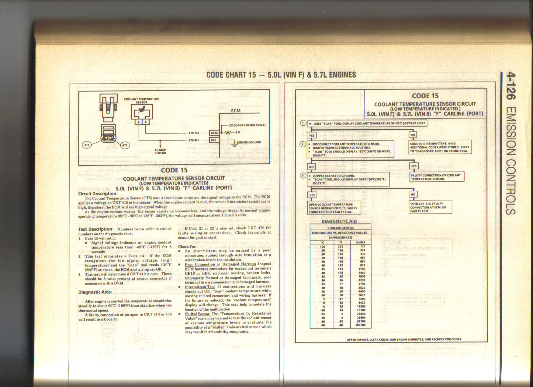

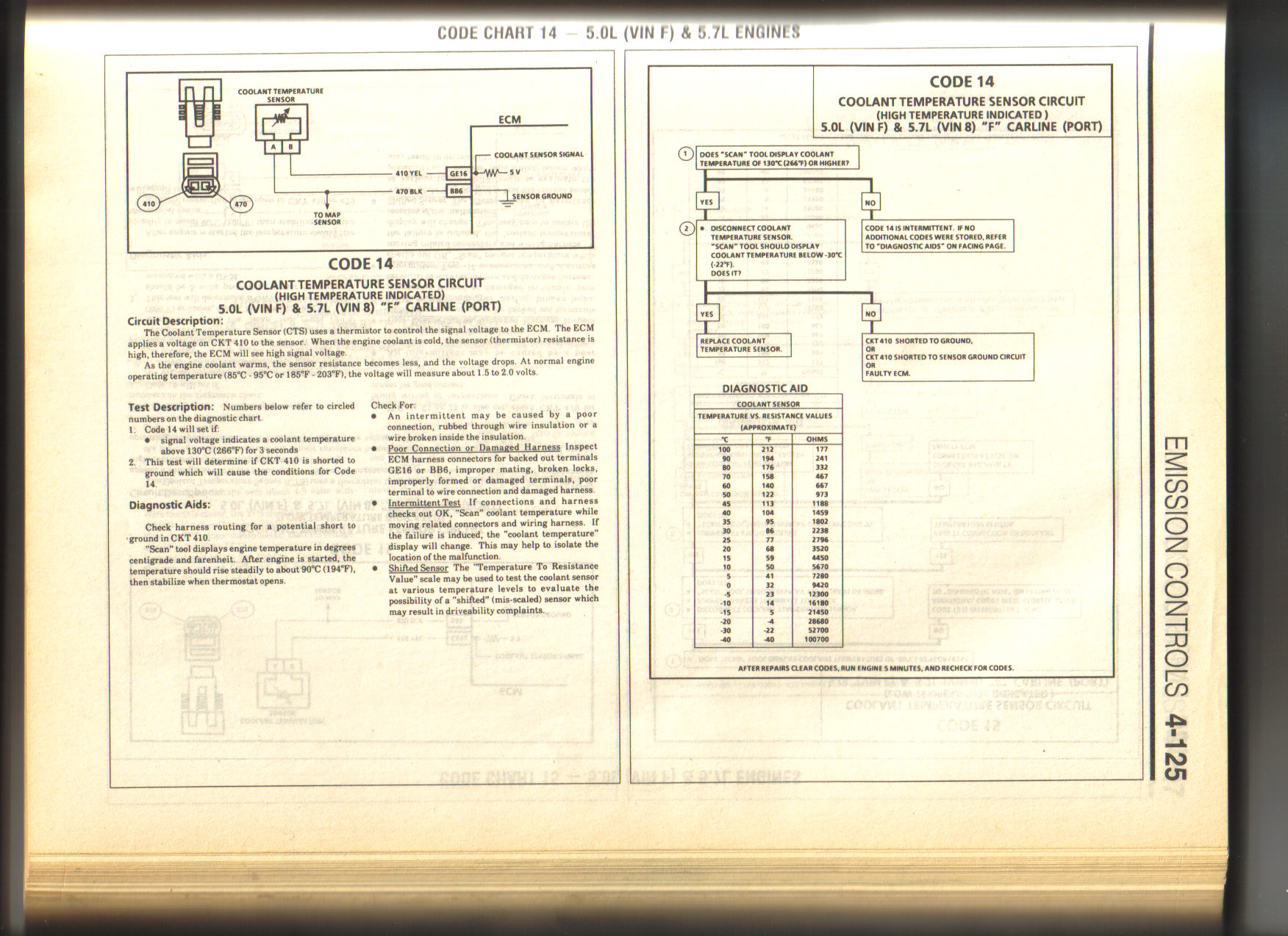

Here is a couple diagnostic charts for the coolant temp sensor. They should get you going in the right direction. From what you stated, sounds like a wiring problem or a bad ecm. Hope these help you out.

Thanks alot for the flow charts. They say that it could be a short to ground if the voltage was 268 for at least 3 secs. First off the voltage didn't go up to 268 degrees. Next when I disconnected the sensor, the voltage changed. If it was shorted to ground i don't think the voltage would change because the short would be b4 the ECM obviously. What you guys think?
