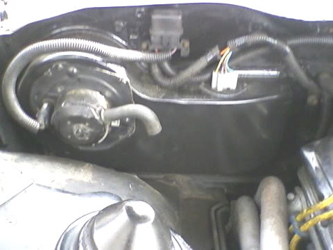

You can use any blower you'd like, the connectors are irrelevant, just rewire everything like I did. I used an A/C delete box from a G20 van, and a blower motor from an entirely different vehicle (I cut the connector harness along with it), but with the right size cage. I reused the stock AC resistor from my car to retain all four speeds, hooked it up to the main harness, then spliced it into the new blower motor. I get all four speeds, no problem....
https://www.thirdgen.org/forums/fabr...tml?highlight=

Mid-late 80's is what I got mine out of, and the similar year S10's used the same box. You have to do a couple of things to make it fit https://www.thirdgen.org/forums/fabr...want-c-so.html This should help you out if you go the G20 route. James
