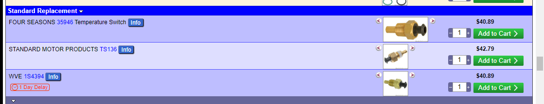

I can't get Buick Grand National to list in the auto parts. Do the other Buicks of the 80's take the same stat?

I think there referring to wells sw555

Thanks. I tried that one and it came on at 220 and off at 205 for me.

Summit has a wide variety of single wire 3/8npt switches to choose lower on/offs

SW555 or any of these

Yeah thanks. I was going to try the TS 136 next.

After having the original go bad and the fan running all the time to the GM recommended and not running until 234 to this TS135 the fan starts at 204. Perfect!
Seems all that's on the shelf in CA is to run us too hot???
