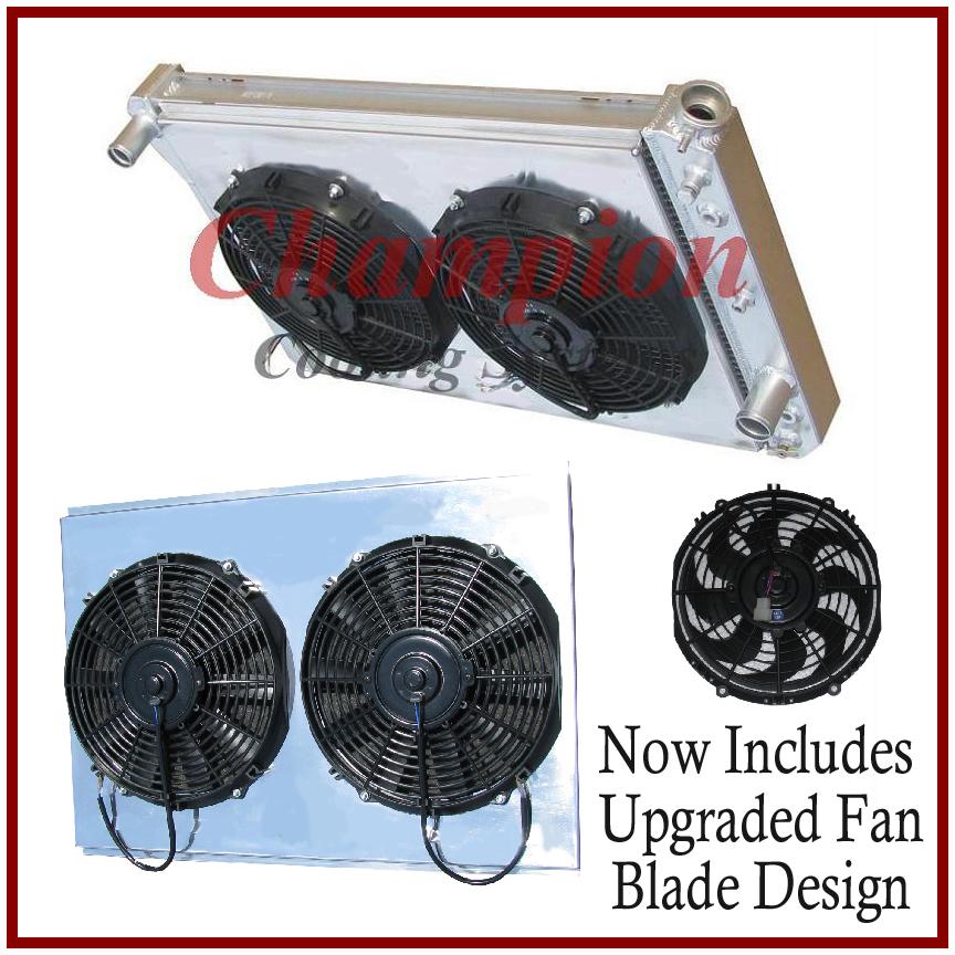

Alright guys, totally been messing around, but here they are.
Fan Shroud
Gauge = 1/16"
Total Length = 25-3/4"
Inside Length = 25-5/8"
Total Height = 18-5/16"
Inside Height = 17-3/16"
Total Depth = 5/8"
Inside Depth = 9/16"
Fan Opening Dimension = 11-3/16"
Fan Shroud Mounting Bolts, Nuts, Washers
Note: I am using the slotted section of the radiator to mount to, instead of the single hole next to it.
Fans
Fan Ear Mounting Dimensions (Square Mounting Style) = 9-3/4"
Fan Ear Hole Size = 1/4"
Fan Ear Thickness = 1/4"
Fan Ear Mounting Bolts, Nuts, Washers
Note: Some Drilling out of the Fan Ears may be needed to squeeze the 1/4" bolts through.
I decided to use the same size Bolts, Nuts and Washers, for ease of install and since the nuts and washers come in packs of 50 and 100.
I think thats everything needed to know for mounting, let me know if anything is confusing.

Re: So you guys want a bolt in all aluminum 3 core radiator?
My single fan was actually hitting the rad so I was going to shim it out a little but then decided to ditch it altogether. Do a search for shrouds and you'll see how some have used cheap aluminum from Home Depot to make a shround setup for the single fan, they said it helped alot. I'd try that first on the original radiator if you want to keep the single fan, before even changing the radiator to a new one.
I bought the Champion shroud/fans and I wasn't thrilled with the fitment to the rad, I felt the mounting flanges could have been bigger and it was a tad too high. I also heard the chinese fans they give aren't the best flowing cfm either. I returned it and had TCP Performance custom make me a shroud with dual 12" Spal fans. I removed the a/c lines for clearance but could have made it work but since my a/c was shot anyway I removed them for now. The fans I got are also the deepest ones, one fan model down would give more clearance but 300 cfm less per fan as well. This setup cools QUICKLY!! I just finished yesterday and with only one fan running it went from 210 down to 180 in maybe 3 minutes.
