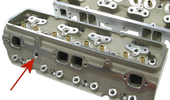

Stock temperature for a fan switch (for all motors as far as I have seen) is 238°F turn on.
Originally Posted by tony_cogliandro
he can also do a dump of the obd and see if there is a problem with the fan switch.
The TBI fan is not ECM controlled (for whatever reason) so replacing the coolant sensor on the intake won't change the fan issue. The fan switch is a simple on/off switch that works at a set temperature.
The switch is located between the number 6 and 8 exhaust port (passenger side. It is screwed in the the water passage in the head (1 and 3, drivers side, is where the gauge sender is).
If you can see the gauge sender on the drivers side, then you know where it is on the passenger side. It can be gotten to from the top with some (a lot) contorting or. from the bottom side w/o taking anything off the engine.
The knock sensor is also on the passenger side but, it is screwed into the block and considerably larger than the fan switch.
If you can pretend you're looking at the motor from the passenger side fender, here's where the switch would be... (attached image)

Old Sep 7, 2009 | 07:02 PM
tony_cogliandro's Avatar
Joined: Sep 2006
Posts: 1,531
From: sunny so cal.
Car: 1990
Axle/Gears: stock
Re: over heating.
hey thanks for that pic - i learn something every day i go here.
Old Sep 8, 2009 | 03:04 PM
almoe's Avatar
Joined: Oct 2008
Posts: 6
Re: over heating.
Thank you. Great to see a pic. I think I will be replacing the gauge sender also. Thanks for mentioning that too.
