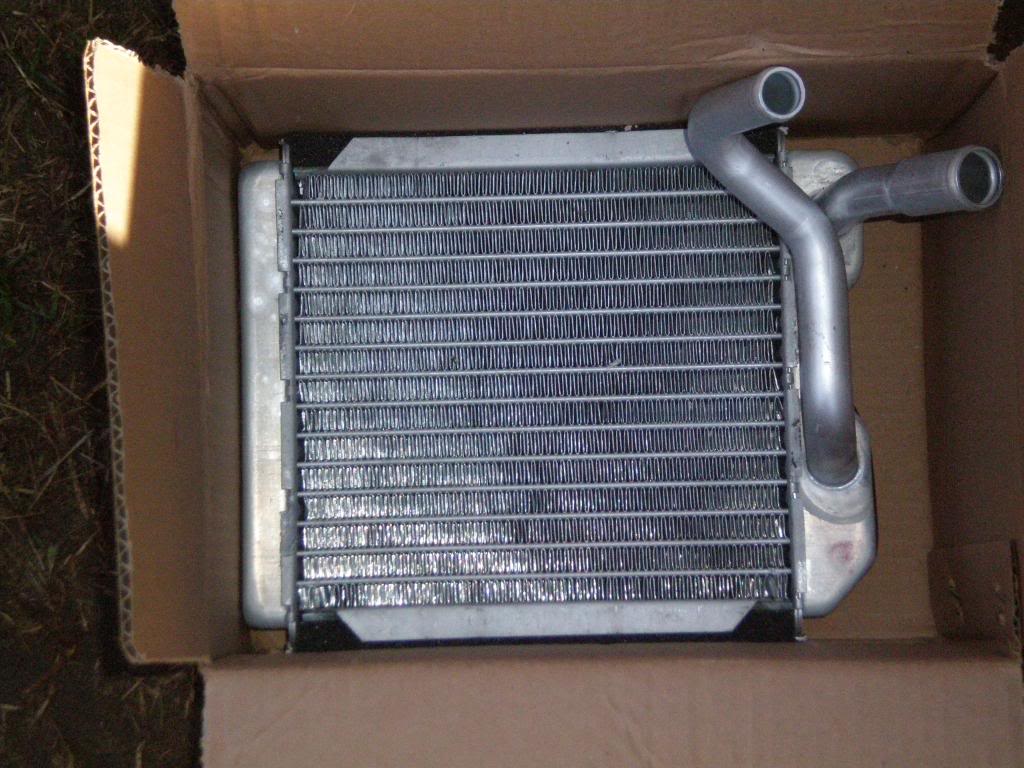

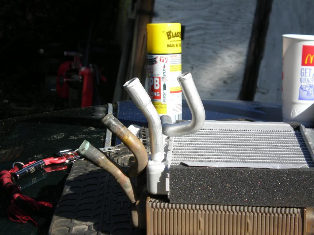

i did my heater core today and it was easy the haredst part was getting my bypass unhooked ! i didnt wanna cut the heater hose but i did iam happy i did it myself ! it was way faster using the seatless method lmao ! it was a breezy did it in a hour ! had to bend the new chepo core just like the old one and and it fit after a lil wigglin in !
few pics
old heatercore
new heatercore
heater core matchin (the bending)
before the bend
after the bend
iam post more pic in the next post !

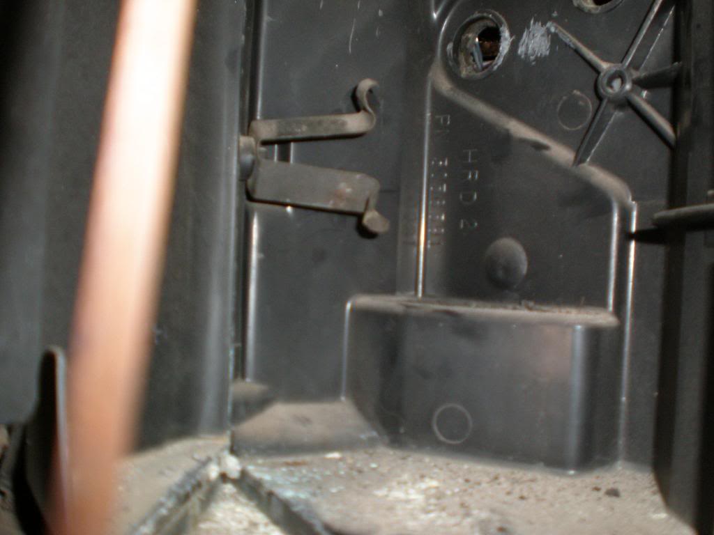

heres some shots of the location for the core !

just put the hoses back on a run the engine and check for leaks .
if everything is ok button everything back up !
good luck !
its not bad as it seems just stay calm take breaks if you have too and remeber think outside the box some time ! on my 84 z28 i used the manual and it took me around 6 hr to do this and today it took me a hour good luck !
