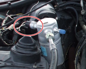

Did you have power at the pressure switch you were jumping?

Did you check for voltage at this switch?
86 IROC A/C trouble shooting.-switch.jpg

No, I didnt but I sure will. I guess it should only be hot with the AC on right? Or is it hot all the time and then completes the circuit when you turn on the AC?

When the ac is turned on one of the terminals on this switch will have power. If you jump the two wires together it will turn on the compressor clutch allowing you to fill the system.

That did the trick! So I need to charge the system while jumping out the switch for it to get enough pressure to cycle the switch on it's own right?

You should only need to do it for the first can.

Well, I jumped the switch and heard the compressor clutch kick in and then added a can of refrigerant. Still no cool air from vents. The compressor finally cycled off even with the switch jumped out. Then I put a gauge on it and found the system to be overcharged. I then heard a leak coming from the high pressure metal line along the pass side frame rail where a switch or solenoid is tapped into the metal line. There was 2 wires coming from it. I think blue and brown. I was thinking wither the orifice tube is blocked or the compressor is shot? The motor did lower in RPM when the compressor kicked on leading me to believe that it was working though. Any thoughts?
