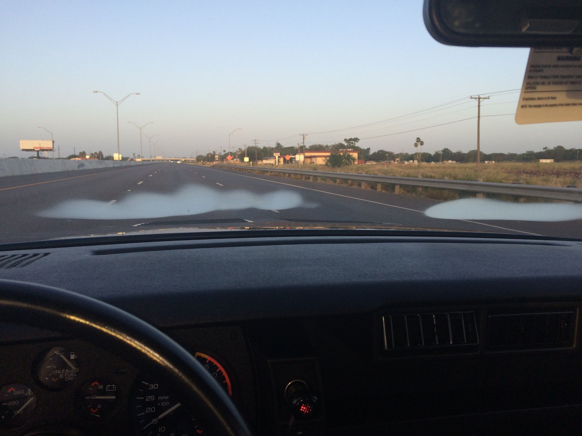

Re: Fogged windshield
My car has the same problem but it only seems to happen in the early morning hours. No signs or smells of coolant, just a lot of humidity. I took this early Saturday morning.
Yes, this is like dew forming on grass in the morning, or when condensation forms on the glass of cars, or siding of a house not yet in direct sunlight in the morning. I think, whether by design, or by wear and old age, that a certain amount of AC cooled air bleeds past the defrost valve, cooling the windshield to the point that humid air condensates on the glass . Some cars seem to bleed cooled air to the windshield more than others. I remember an 89 Grand Am doing this more frequently than any other car I owned as a kid. Of course that car had great AC also.
Looks like my 88 the other morning at 6am here in Huntsville. It was 80 outside and very humid. But....a very cool 40* inside!!!
I do understand the principles behind what's happening but we have 3 other cars and this doesn't happen with either of them. The pic of Lurbie's windshield is minimal compared to my SS.I literally have to use my wipers all the time. But hopefully a change in the weather will change that! Thank you for you post!
