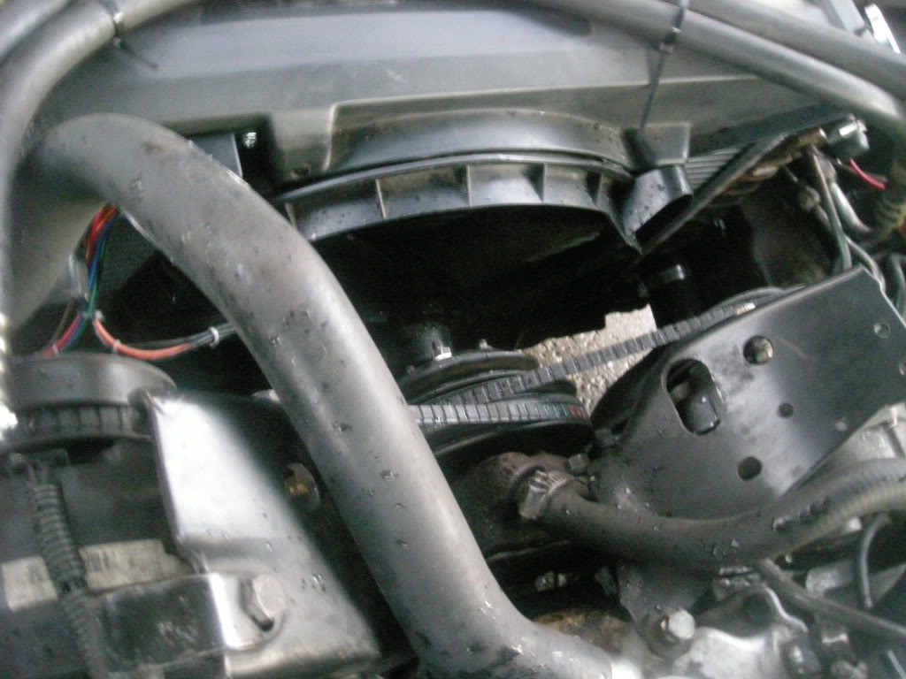

I put mine near the top radiator hose, I think thats what the instructions entail, anyway. Here is a pic, its the only one I could find. I mounted the relay to the upper fan mount and the probe would be to the left of it on this picture:

yeah, that's where i was going to put mine, what 12v source did u use for the ignition. i was thinking cig lighter.. lol

I ran a wire directly from the battery for my constant 12v source, and ran a wire from the Ign. port in the fuseblock for my keyed 12v source.
