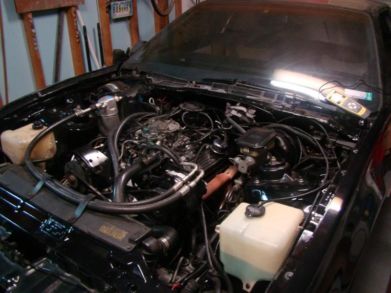

Old Jun 4, 2012 | 01:54 PM
naf's Avatar
naf
Joined: May 2004
Posts: 5,338
Likes: 73
From: Lexington, SC
Car: 1987 SC/1985 TA
Engine: 350/vortec/fitech
Axle/Gears: 3.27 9-bolt
Re: Question About the Thermostat Senor on LG4
Best I got now:
