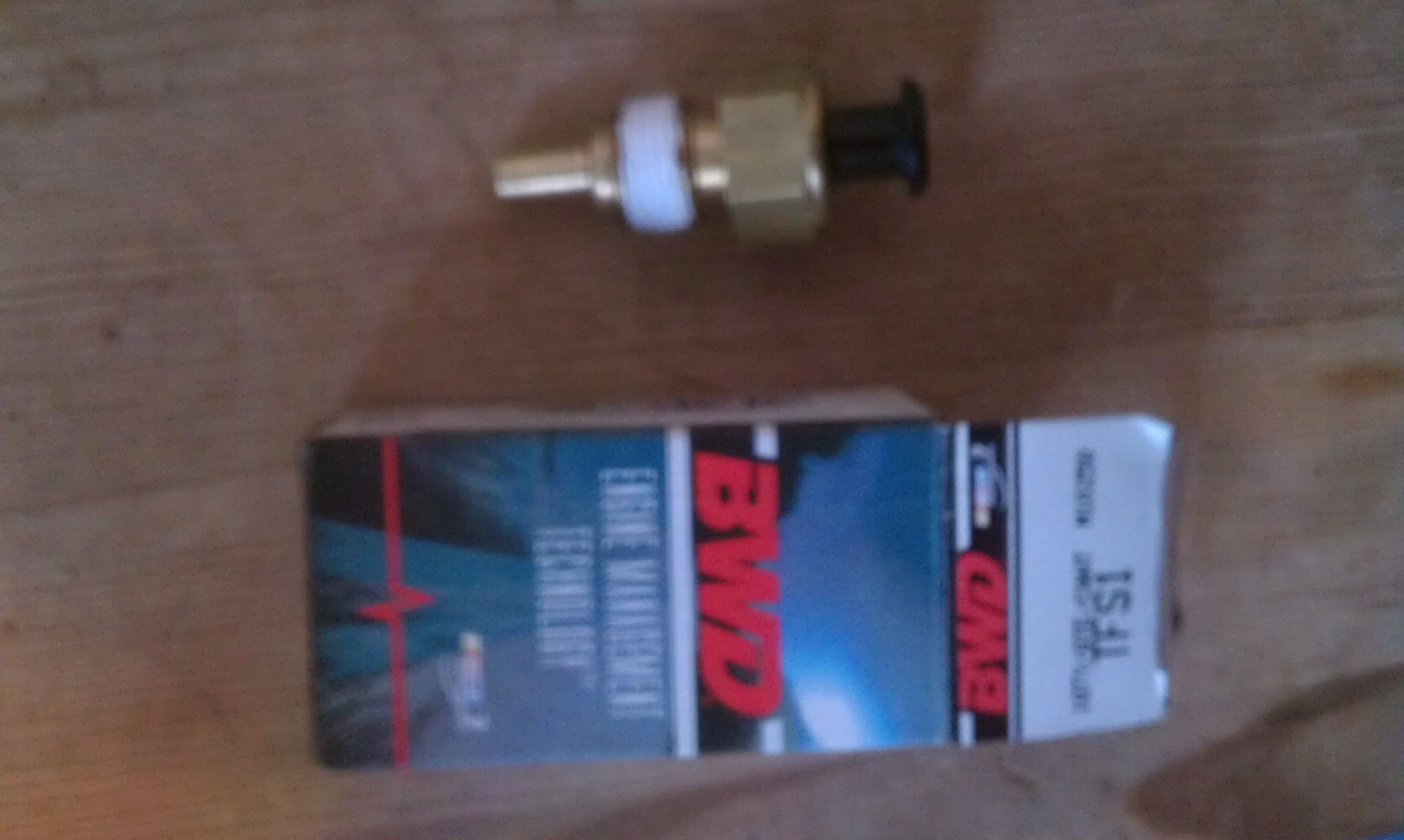

Ok, I'm going F**kn nuts! Fan STILL will not come on! It WILL come on when I turn the AC on so it works. Here is what I did:
1. Changed Radiator Fan Motor
2. Changed Fan Relay
3. Changed Coolant Temperature Sensor
Still won't go on!
Where the F%&K does the "Coolant (Thermo) Fan Switch" (O'Reilly's Auto parts # TFS1) go?!?!? I had the car on a lift and looked all over the bottom of the car. On the Manifold on the Driver's side is the Oxygen Sensor and some other sensor that looks nothing like the part in my hand.
I am about to rip this Chilton's manual in half, its not listed in here. I doubt it's an exotic part and sure does not sound like an uncommon problem. I hunted all over websites and it seems like everyone is asking the same F'n question. Some say screwed into the block above starter - NO! Others say Next to the Thermostat - NEGATIVE! Where does this thing go (description? Photos?) before I end up buying a new ECM when I don't need it. F#$K!
Attached Thumbnails 1990 305 cooling problems-coolant-thermo-fan-switch

Either that's the wrong part or it goes in the driver side head where they mentioned above lol. OR, it's very possible it was removed and someone put a block off in it's place. Are you able to get a picture of between #1 and #3 cylinders on the underside of the car? That may help, but it'll point out any obvious wrongs for sure.

There is something between 1 & 3 but looks nothing like this thing. I tried to get a pic with my phone but its too tight.

You may have the wrong part then

I fixed it. Man, I was about to lose my mind. I took pics and everything, I'll post them when I get a chance to cover the part Chiltons forgot.
Old Jun 13, 2012 | 02:32 PM
PUNISH3R's Avatar
Joined: Mar 2012
Posts: 361
From: SoCali
Car: 1989 Pontiac Firebird Formula
Engine: V8 5.0 305 TBI
Transmission: 700R4 with B&M MegaShifter
Axle/Gears: Gear Ratio: 2.73 Ring Gear: 7 5/8
Re: 1990 305 cooling problems
Alright, after changing the Radiator Fan Motor (O'Reilly Part #PM517), Coolant Temperature Sensor/Sender (O'Reilly Part #WT3000) and Cooling Fan Motor Relay (O'Reilly Part #2DR1042) - they were all original and pretty beat up anyway - I still wasn't getting the radiator fan to kick on!
The last thing I through to change was something called the "Coolant (Thermo) Fan Switch" (Part #TFS1 www.oreillyauto.com/site/c/detail/BWD0/TFS1.oap?ck=Search_tfs1_-1_-1&keyword=tfs1 ). No worries but I COULD NOT FIND THIS THING on the car!
Chiltons DID NOT have it listed in the 82-92 Pontiac Firebird Manual and I read a ton of forums online where people couldn't find it, which was the Butterfly Effect of Chilton's not publishing it. To find it (in a 89 Pontiac Firebird Formula V8 5.0 305 TBI ), put the car on a lift, get underneath and shine a SureFire up where the oil dipstick is and you'll see it sticking out. Its SUPER hidden, you cannot see it from the top of the vehicle and it is practically touching the oil dip stick (See 2nd photo).
Then I saw my problem, wiring harness connector was broken off (See 3rd picture), and the switch itself was original, it was going to have to be changed eventually anyway (See 1st photo). All parts cost me less than $50 with lifetime warranties, why not replace everything?
I squeezed a ratchet in there, its tight up to the dipstick, and removed the old one. BE CAREFULFUL! ENGINE COOLANT CAN BE FRIGIN HOT so UNLIKE me, drain your coolant first! Remove old one, install new one. Easy.
Like I said the harness was just deteriorated so I crimped a blue wire connector on to it and it snapped right into the Coolant Fan Switch, PERFECT (See 2nd Photo again).
Lowered her off the lift, filled her with coolant, fired her up, let her run till about 236ish degrees and the car fan sputtered ON!
