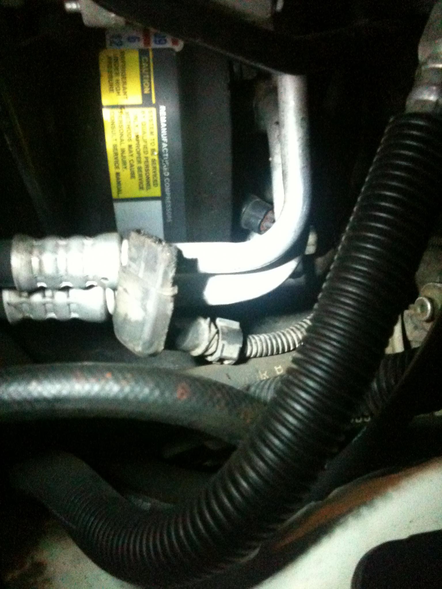

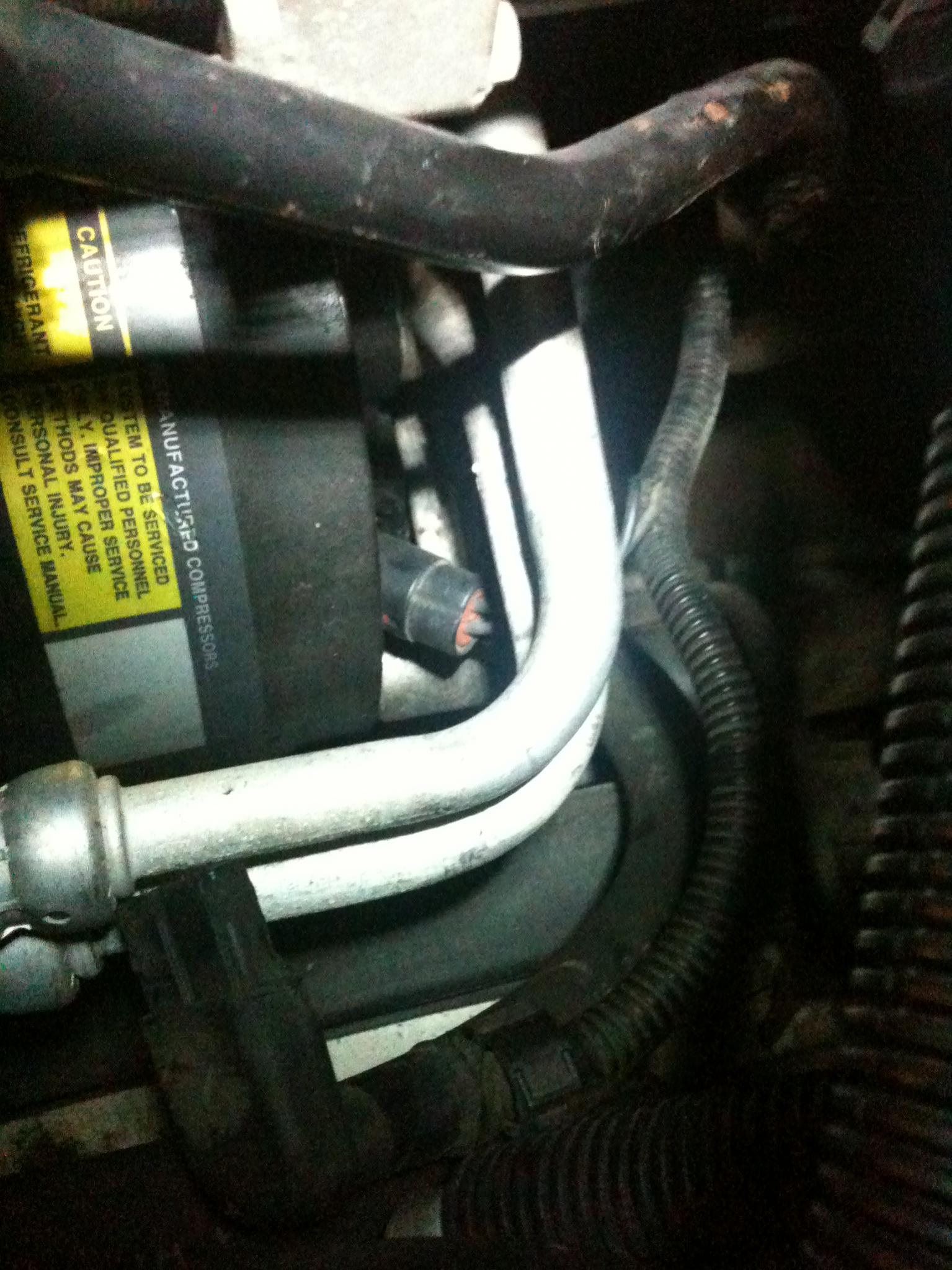

i did fine this harness loose under the compressor, were would it hook uo too?
That should go to the high pressure switch at the back of the compressor (IIRC the switch is in the back of the compressor held in by a C-Clip).
I am getting ready for my first venture into air conditioning, but from what I understand if the system does not see pressure at this switch it will not cycle the compressor on because it thinks the system is empty and would burn the compressor up running it with no oil.

ok thank you sir I'll have to look for it in the morning i dont have mutch light to work with..maybe he knocked it loose taking off the valve cover? what i do know its hot as hell down here and i hope this works lol

Thank you that was it! A/C back to normal
