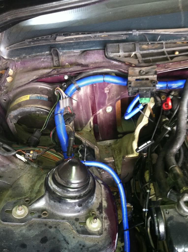

Im in the process of removing my AC I can say I'm about 85% done i removed just about everything . I just need help with the AC BOX . I'm stuck at this point so if anyone with the knowledge on this can input them i would appreciate it.

I think there are a couple bolts from the inside, IIRC.

under the dash?

Yup. Peel back the carpet and they're right there. 10MM, IIRC.

Yup 3 of them they go into the plastic plugs in the lower part of the box. Your non AC box will have only 2 of them so you will need to plug the remaining hole.
