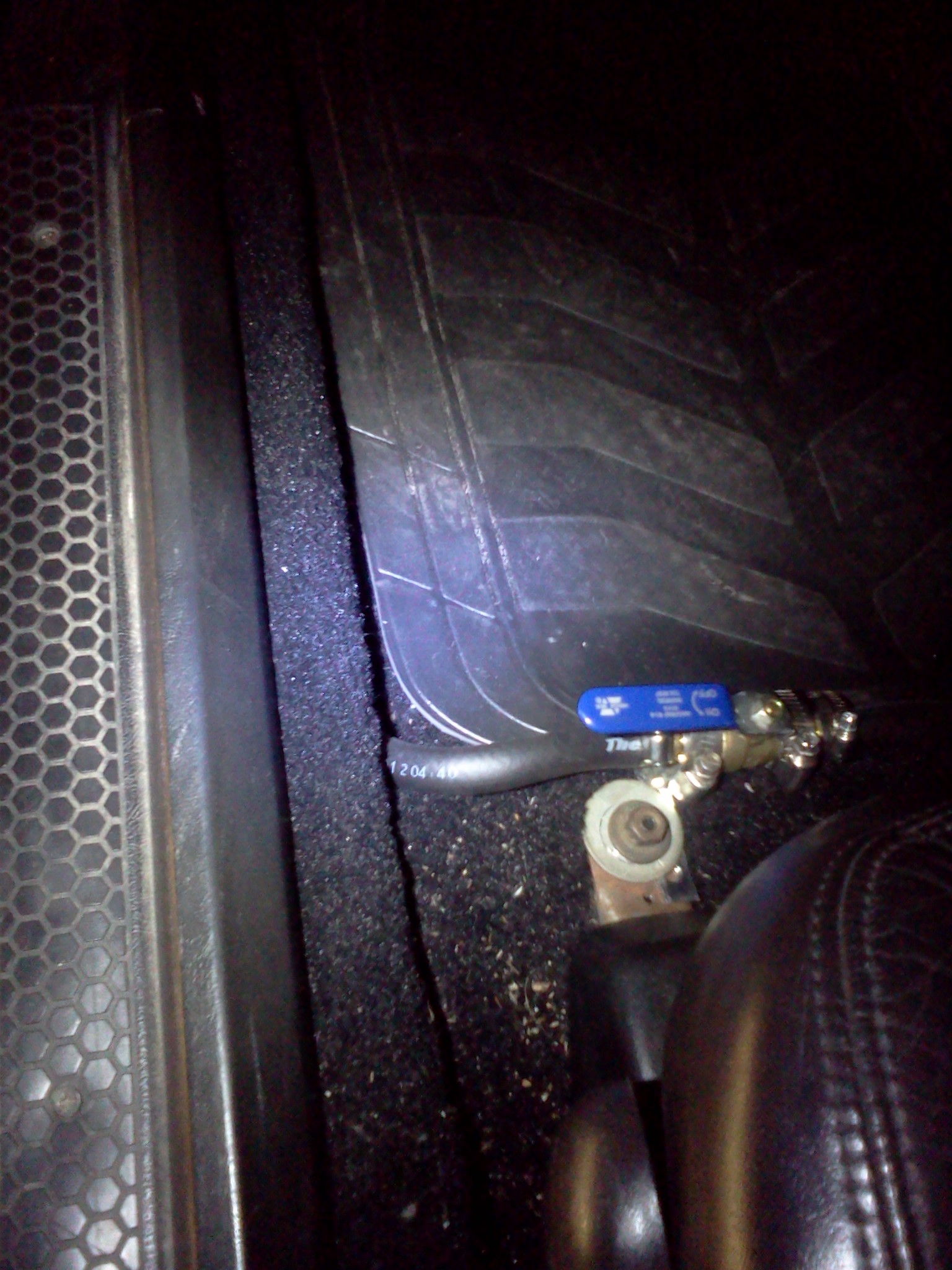

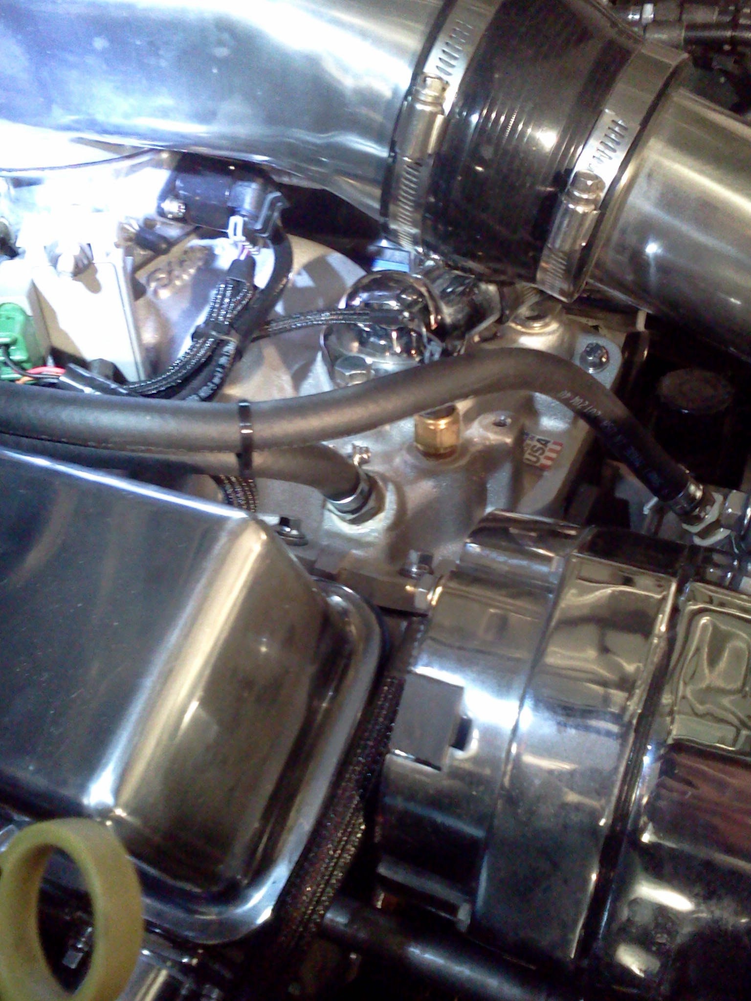

I got rid of my heater core and decided to do something different. I ran some 3/8" hose from the intake manifold coolant outlet, through the firewall, around the gas pedal, looped around in front of the seat, then went back through the firewall to the waterpump. I installed a handle-valve right in front of the seat so I can shut off the flow if it gets too hot in the car. I gotta say, it works really well. Later on, I'll add some more hose and loop it around the passenger side floorboard so passengers can also get some heat.

A hose full of hot coolant will certainly put out some heat. I have nearly 10ft of the hose in the cabin. I was just posting this on here to say that there is options for heat other than using a heater core.
