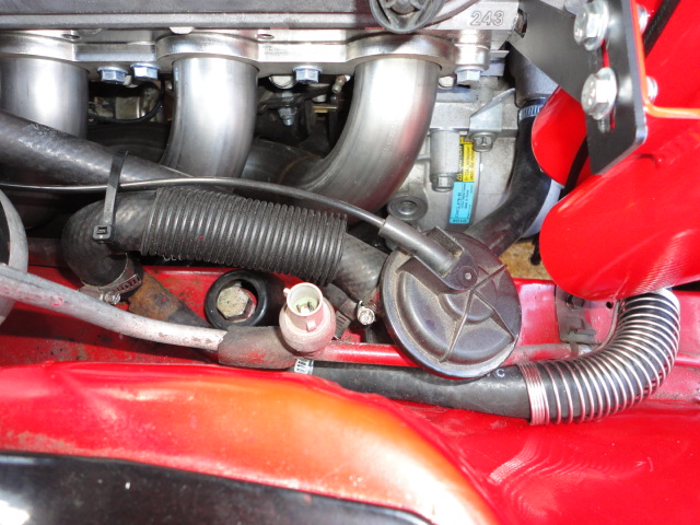

Something like this?

Re: Adding a Heatercore bypass valve?
No.
More like this.
Just run the coolant lines cleaner and closer to the crease between the intake and the valve cover. I have the valve roughly above the #4 cylinder.
