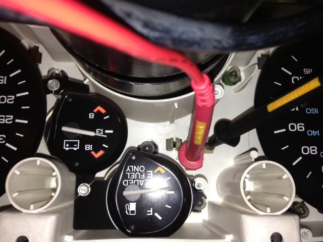

So I pulled the temp gauge out to see if anything obviously wrong. Didn't see anything. Put it back in and now it is either pegged all the over top or bottom. Took it out again to put a multimeter on the socket and test resistance. Took some pics - I think everything up to the gauge is ok. What do you guys think? I am thinking of just trying to find another gauge and see what happens. Pic shows where the meter was plugged in. Ohms rises the longer car runs. As it gets hotter.

If the gauge just spikes, it is grounding out somewhere. If it doesn't move, it is dissconnected.
