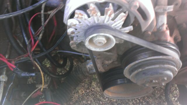

You have the wrong water pump dude. You have the standard rotation not the reverse for the serpentine belt setup. Pull it and take it back. Tell them they gave you the wrong pump and if they try to tell you it is the same throw a fit. Probably need a new thermostat too, high temps will cook it. I have the same setup 355 with dual electrics that run all the time and mine gets nowhere near that hot. I will add that I live in South Texas.

86 should have v-belt setup and use standard rotation water pump. You can verify the correct water pump by observing the flow as I stated above.
The temp guages are notorious for being off. Do not assume they are any indication of the actual state of nature at the end of the sensor.

Its not a stock engine, I have no tensioner pulleys or idler pulleys, Just the alternator which is on the passenger side, the water pump and the crank, it spins the water pump clockwise. Which thats the pump I have on it, or so autozone tells me. and its a standard belt, not a v belt, now i do have a v belt that goes to the power steering only.

Both, the bottom one goes around the crank, alternator, and waterpump, top goes around crank and power steering
How about a picture. I don't think I've ever seen both a serpentine belt and a V-belt used at the same time.

Here are the pictures, ok there seems to be an excsive amount of pressure, i drained some of the coolant as you are supposed to do with the compression leak test (the one with the fluid) and it builds up so much pressure no matter what that coolant comes out, i jumped back after moving the tester off and it had fluid running out, i shut the car off and it sent about a 4 foot stream of coolant out the top of the radiator.
Attached Thumbnails camaro overheating-100media_imag0456.jpg   camaro overheating-imag0455.jpg

So after noticing that i am more leaning back to its the wrong pump again. I think i need a reverse but my knowledge is limited.
Old Jun 24, 2013 | 06:48 PM
  #46
naf's Avatar
naf
Joined: May 2004
Posts: 5,338
Likes: 73
From: Lexington, SC
Car: 1987 SC/1985 TA
Engine: 350/vortec/fitech
Axle/Gears: 3.27 9-bolt
Re: camaro overheating
Your 86 uses a standard rotation pump. It has a v-belt accessory drive. Do not be confused by the width of the belt that runs the alternator.
Have you even determined that it is overheating yet?

It is over heating, the gauge is almost dead on
Old Jun 24, 2013 | 07:04 PM
  #48
Dinmiller's Avatar
Joined: Mar 2009
Posts: 48
From: Texas
Car: 86 Camaro IROC-Z
Transmission: 5-speed man
Is it normal for it to shoot coolant like that?

your waterpump is the correct one for your mid-85 through 87 style pulleys-'88 up is the reverse rotation.
