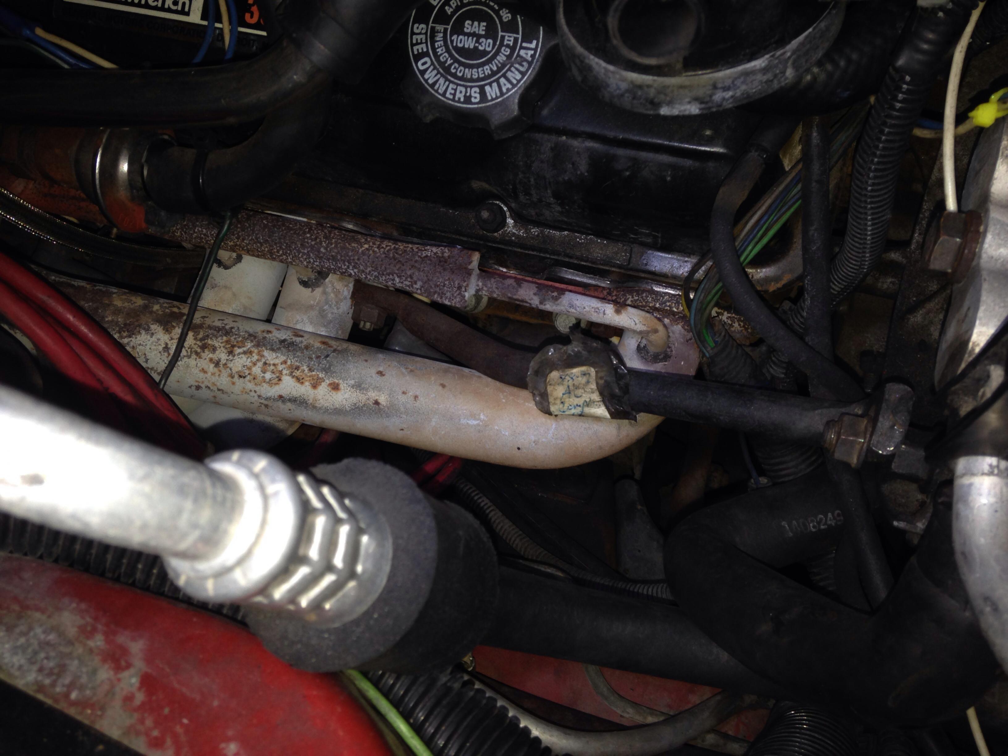

It will fit, I have headers as well. Here is a picture of my brace.
I couldn't get mine to fit around my Hooker Headers.
Old Oct 15, 2013 | 09:53 PM
mcquigg's Avatar
Joined: Aug 2010
Posts: 102
Car: 85 T/A
Axle/Gears: BW Limited Slip 3.27 w/disc brakes
Re: Serpentine AC Conversion Question
I know header designs vary a little but i would think that the pipe for #2 would be the same. mine isn't a perfect but if your header clearance is tighter they may pose a problem.
