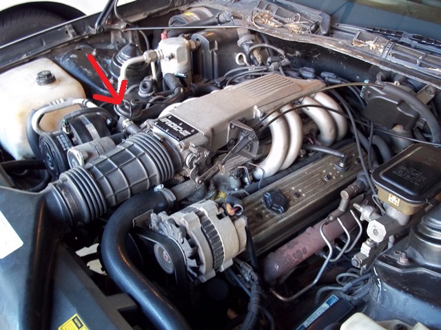

Re: how long does it take to heat up?
Check the heater control valve $15 part, make sure vac line is hooked up.

jersy i got a 3.1 not a tpi
Still should have a heater control valve on 3.1, it may look different or be located elsewhere ... check w/other 3.1er's ...
