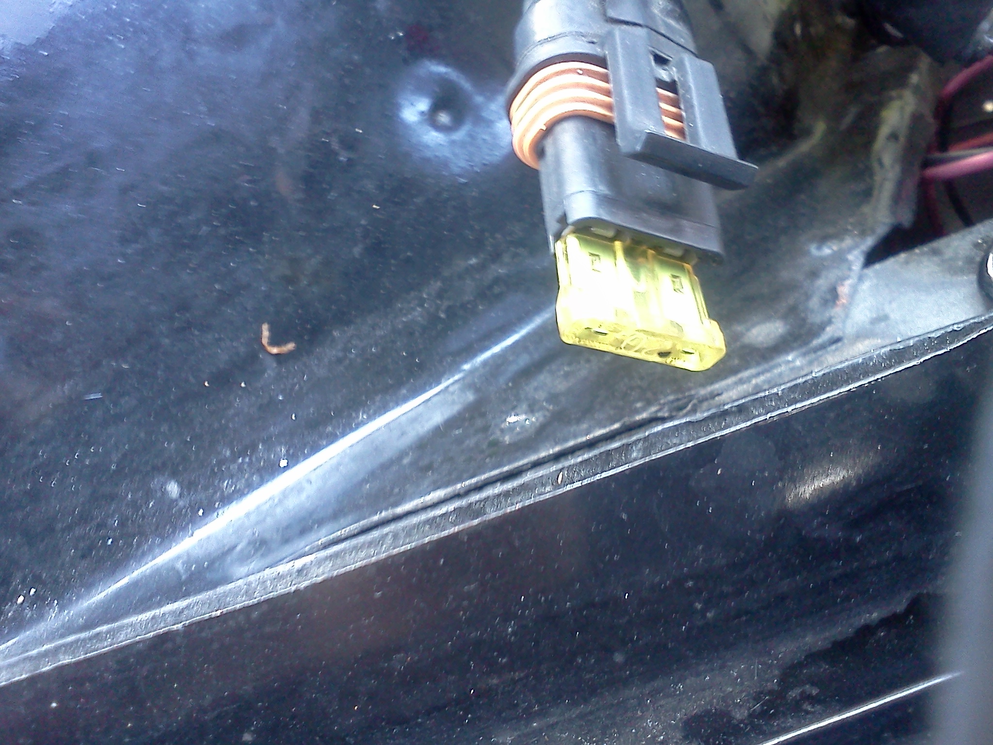

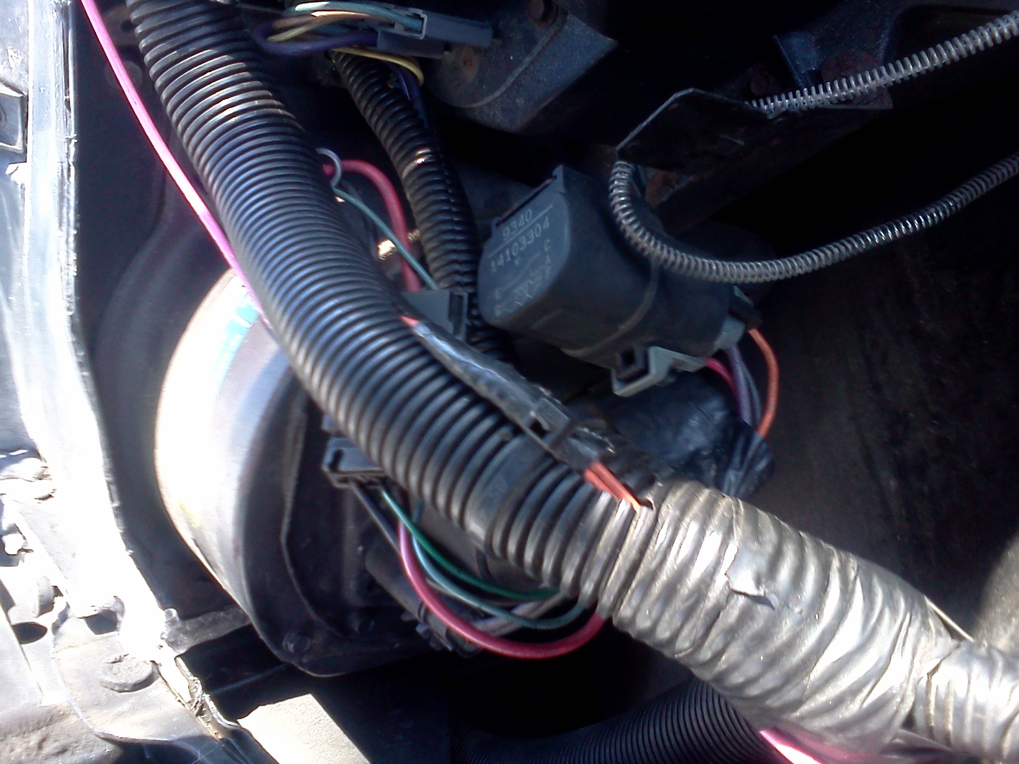

Pics,
Attached Thumbnails overheating-securedownload-11.jpeg   overheating-securedownload-25.jpeg   overheating-securedownload-21.jpeg

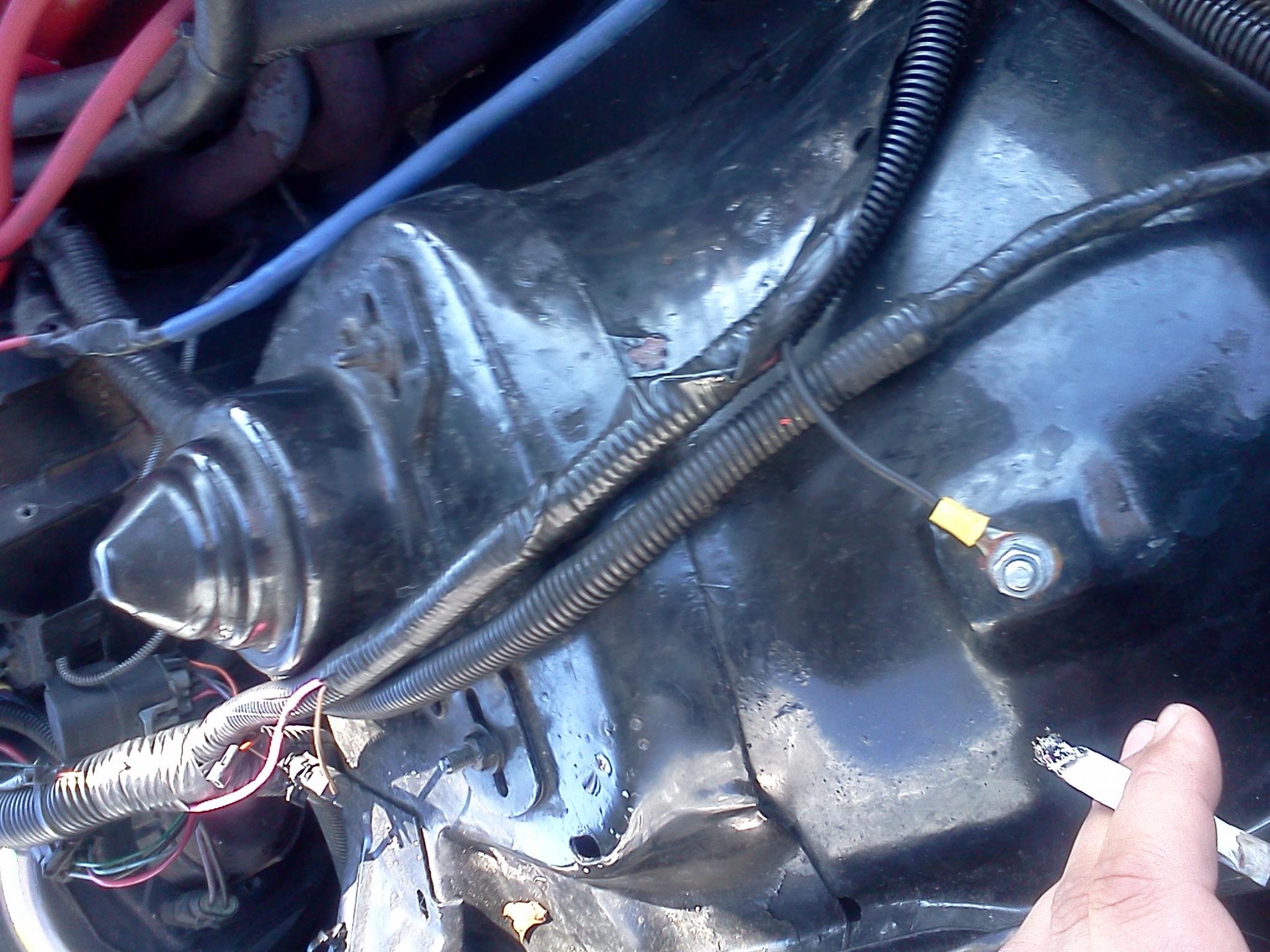

Re: overheating

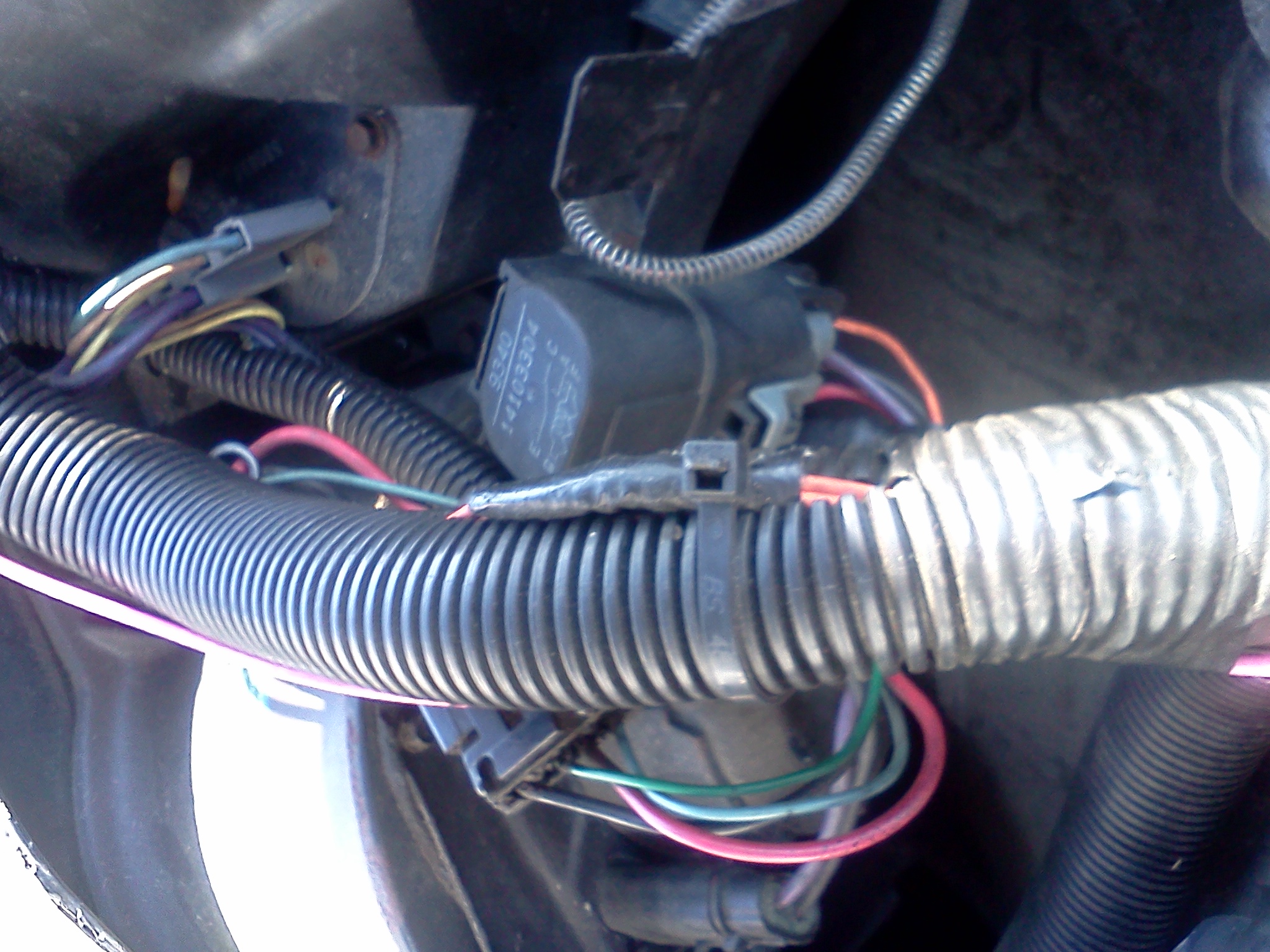

Pics
Attached Thumbnails overheating-securedownload-18.jpeg   overheating-securedownload-20.jpeg   overheating-securedownload-15.jpeg

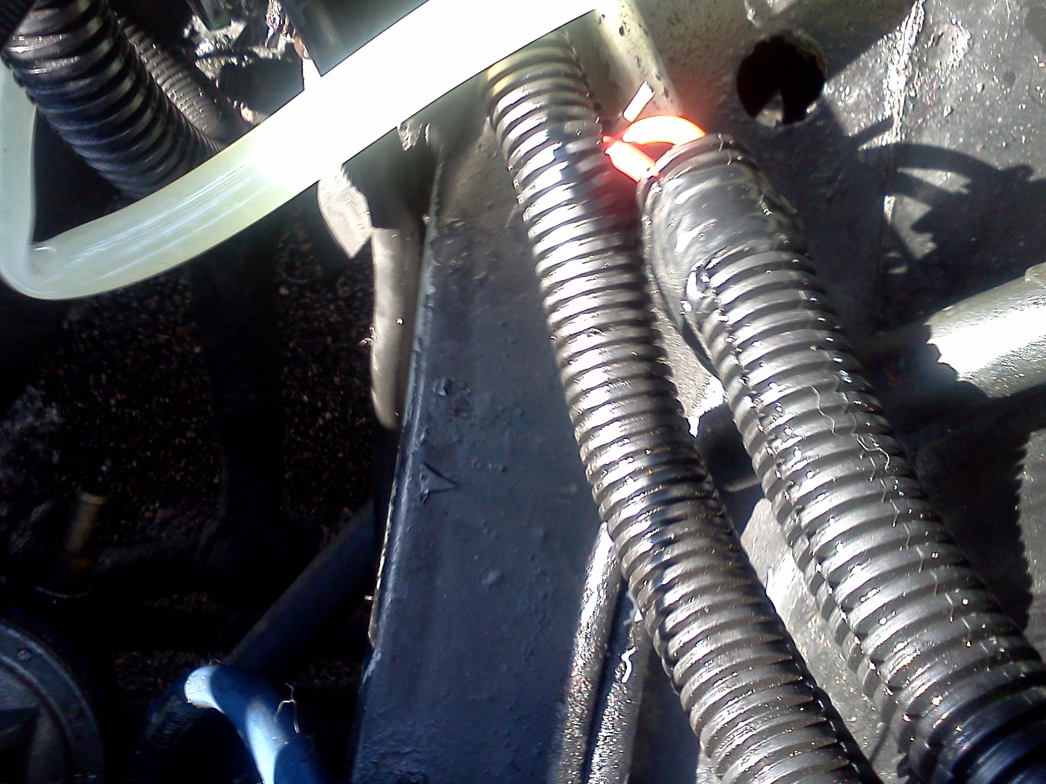

Here are more
Attached Thumbnails overheating-securedownload-8.jpeg   overheating-securedownload-21.jpeg   overheating-securedownload-10.jpg

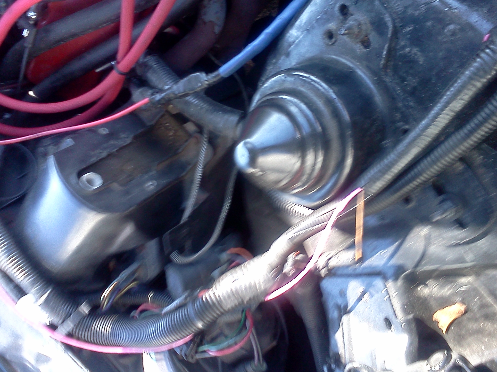

Thanks
Attached Thumbnails overheating-securedownload-20.jpeg   overheating-securedownload-9.jpeg   overheating-securedownload-12.jpg

You can probably use that kit but I would not use the sensor it came with. I would probably use something like the SW555 sensor and the PT308 or PT770 pigtail.
Kind of hard to see.
1. Is the fuse blown?
2. Where is the sensor that detects voltage?
3. What happens when you short the above sensor to ground?
Would you consider building your own? You can get most of the parts at autozone.
Get a 20A fuse holder
40A relay
http://www.autozone.com/autozone/acc...er=203873_0_0_
Relay holder or spade lugs
Wire
SW### sensor and pigtail then wire it all up
Or something like this would be better than the autozone kit
http://www.ebay.com/itm/ELECTRIC-FAN-WIRING-INSTALL-KIT-COMPLETE-THERMOSTAT-50-AMP-RELAY-185-SBC-BBC-/140859700167?pt=Motors_Car_Truck_Parts_Accessories&hash=item20cbe473c7&vxp=mtr

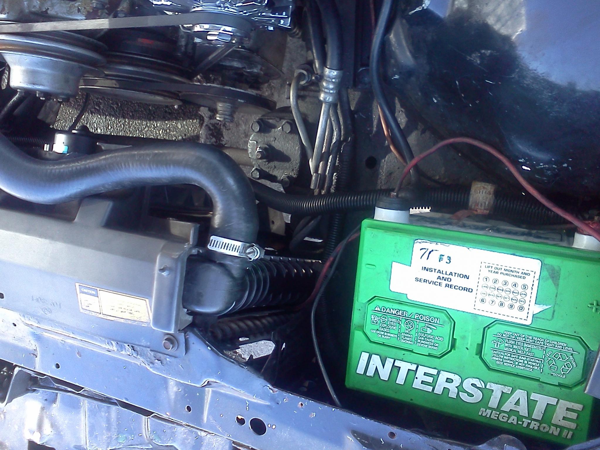

Re: overheating
First Third Gen I've Seen With The Battery On The Left (Driver's Side) Location.
Old Feb 11, 2014 | 01:22 PM
midias's Avatar
Joined: Oct 2004
Posts: 4,528
Likes: 240
From: Henrietta NY
Car: 1984 Trans Am L69
Axle/Gears: 3.42 10 Bolt Posi
Re: overheating
That is a first for me too.
Old Feb 11, 2014 | 02:11 PM
Dakota W.'s Avatar
Joined: Aug 2011
Posts: 1,178
From: Aloha, Oregon
Car: 1991 Christine Z28
Engine: RV Cam and Intake 350 SBC
Transmission: 5speed
Axle/Gears: 3.08 ls Posi
Re: overheating
First one I've seen without a fuse too.
My 88GTA came with the battery on the drivers side and had the air cleaner canister on the passenger side

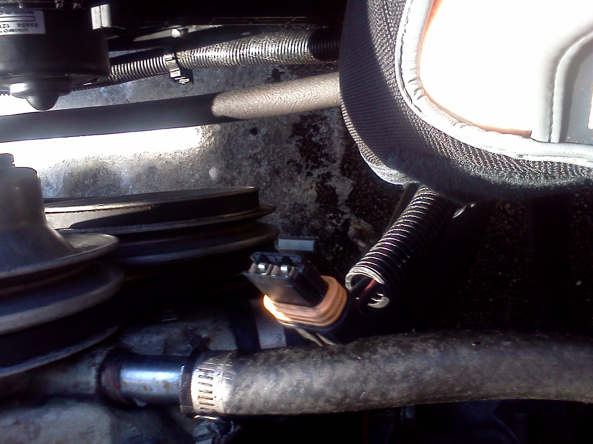

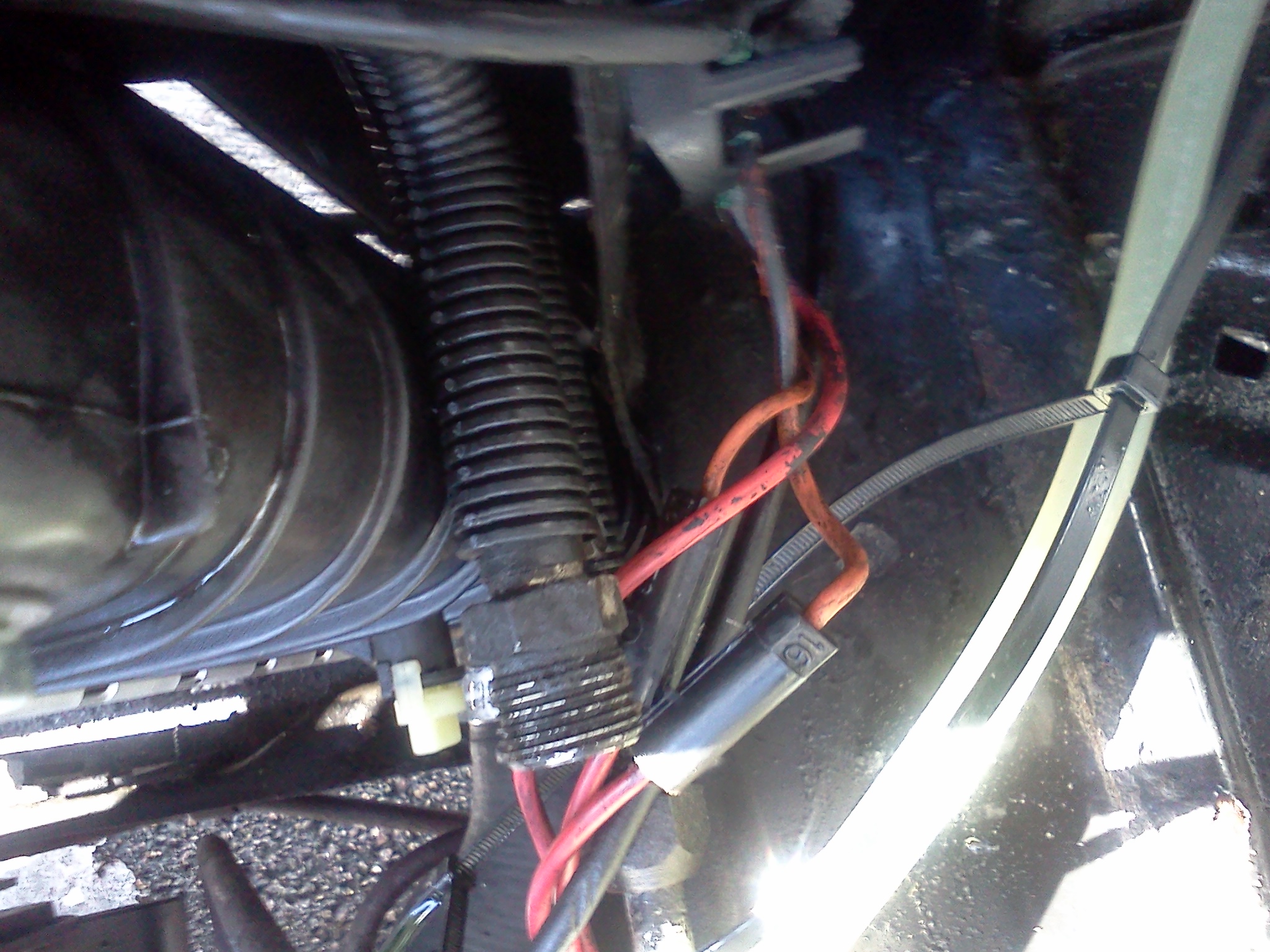

Here this may help. The question has come up a few times lately so I made this. This will create an auto on 210F fan circuit. Swap out SW555 for a different on temp
