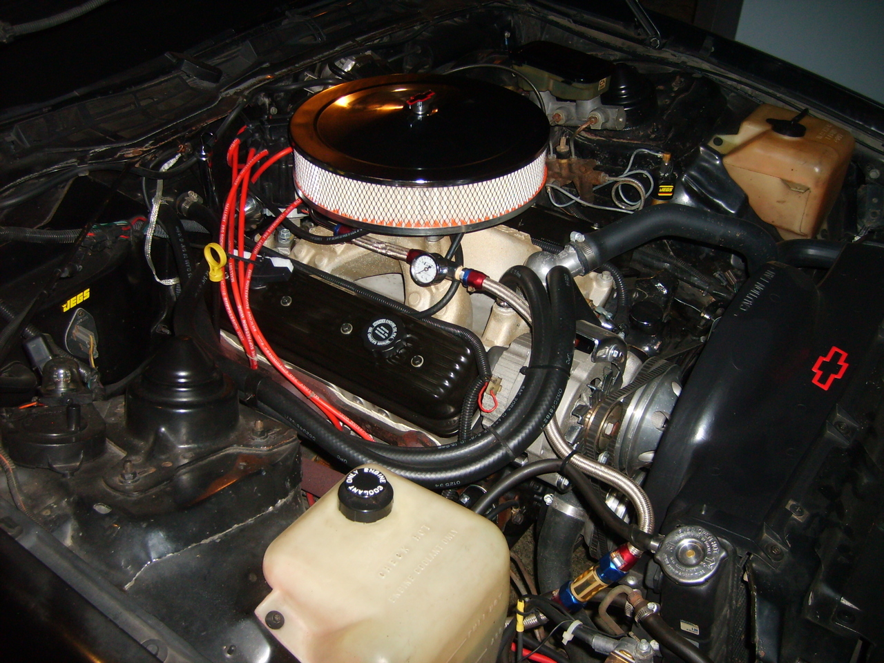

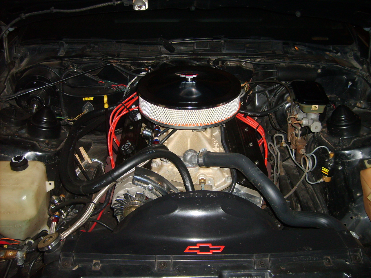

There's two reasons I did not use a AC-Delete pulley.
The more I looked at the pulley the less I liked it. For me it looked totally out of place
Then it started to eat my belt.
So I put the compressor back on for what I thought would be temporary fix.
I left it on because at least it looks like it belongs there.
(the engine in the first photo needed cleaning)

See how Ron removed stuff? That's what your's should look like, good reference photo, Ron.
Yeah, I personally wouldn't care for the random no-use pulley either, if it works fine just spinning the compressor then cool, i didn't know (I have a V-belt set up).

All I was aiming to do was open up the area in the way of the plugs a little so that's as far as I'm going with the removal.
I found nice caps/plugs for the open holes left by taking it out at my local hardware store.

Re: A/C delete question
Finally got to do this job this evening. I ended up not having to go to a shop to get my freon evacuated/discharged. I checked pressure at the schrader valve and nothing came out so i dared forward. Rest assured i went in ready. Jeans, long sleeve shirt, mechanics gloves and had my ski mask & snow boarding goggles on lol. I unbolted the bolt behind the pulley and not a single drip/fume came out.
Tread lightly!!!!
