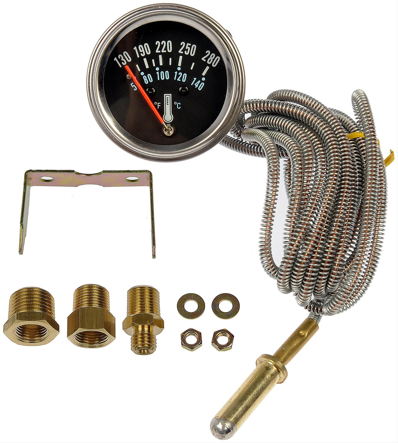

You could replace it with one of these. They use the same type of sender
http://www.summitracing.com/parts/rnb-7-120

The reason is because it has a longer probe like this one. He probably could not seat it otherwise.
