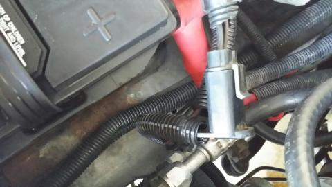

I stole one off a 4th gen, fit in great! Made two brackets from aluminum, took about an hour

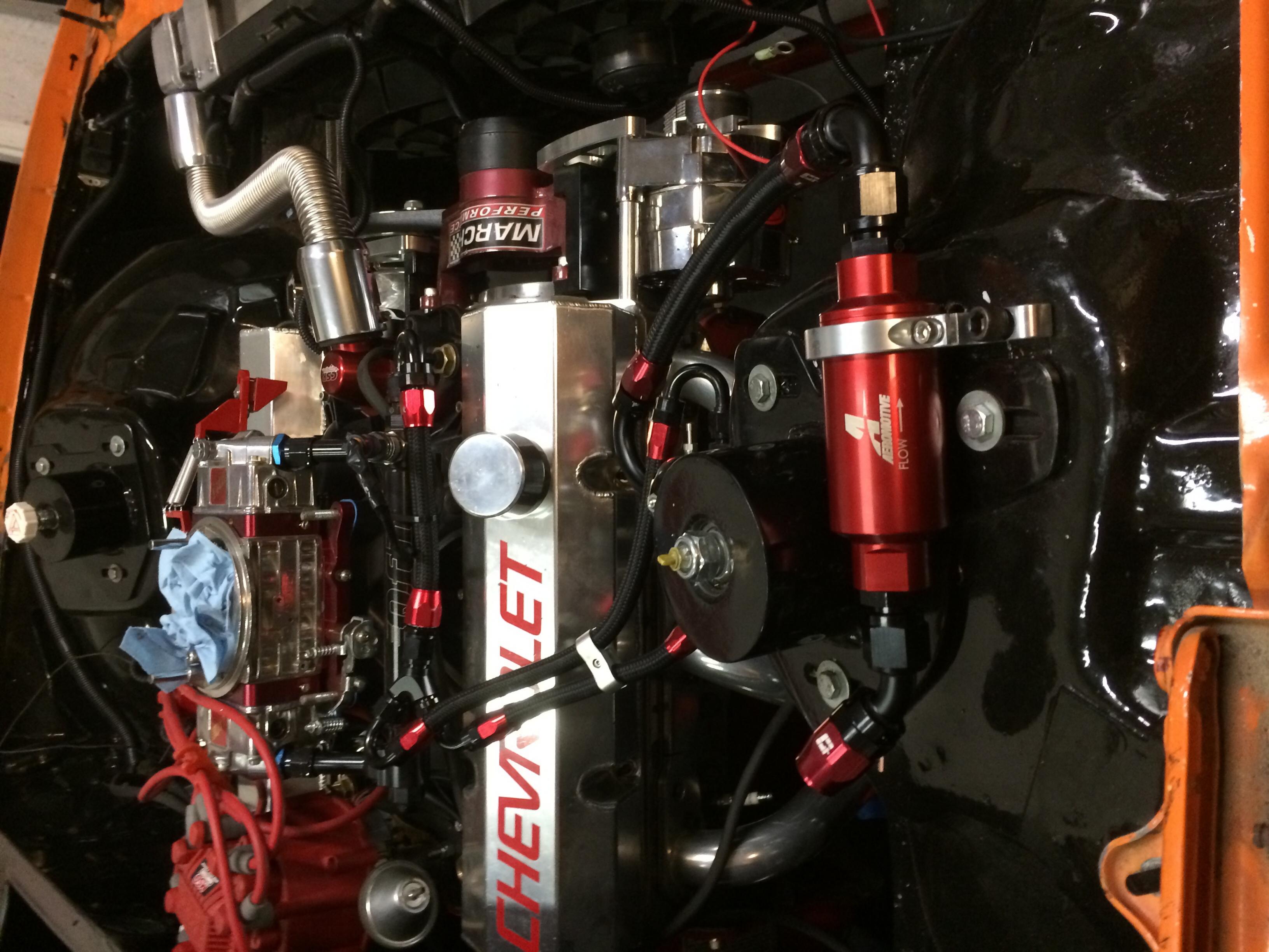

This is my latest 3-speed version....its a 2010-up Mustang GT fan assembly powered by my conversion harness. This is slightly larger overall than the Mark VIII fan. Itsbhas a fairly quiet "S" curve blade and moves HUGE amounts of air!

Here are two pics of the connection I made to the existing single fan plug and the donor fan motor plug to the fual fan harness.
Attached Thumbnails Single to dual fan conversion plus a question or opinions-lt-fan-2.jpg   Single to dual fan conversion plus a question or opinions-camaro-lt-fan-plug.jpg
