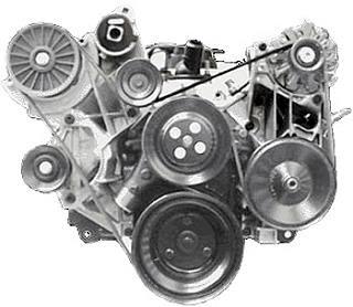

i didnt buy the pully after i removed the smog pump but this image shows how to re-run ur belt
So I can just remove the smog pump and at those ugly hoses that it's connected to and still have the ability to run my air conditioner?

i have none of that..its tight as it was with the smog pump on as it is off
this belt from autozone Belt size "968K6" worked perfect.
before i removed the smog pump i checked the current belt
removed the smog pump n nice n tight
just make sure you follow the new path of how the belt goes on
not whats on your hood for stock belt path.
u can add it and use the old belt path, no harm in using it just another pully to replace when the bearing goes bad
eventually.

I did the same thing. But now I have the A/C working it throws the belt. Is there any way to avoid this without putting a smog pump delete pulley on?
if you followed that picture (minus the extra pully) and used this belt size
968K6 from autozone. then u shouldnt be throwing a belt

belt path..(ignore the delete pully obviously)
