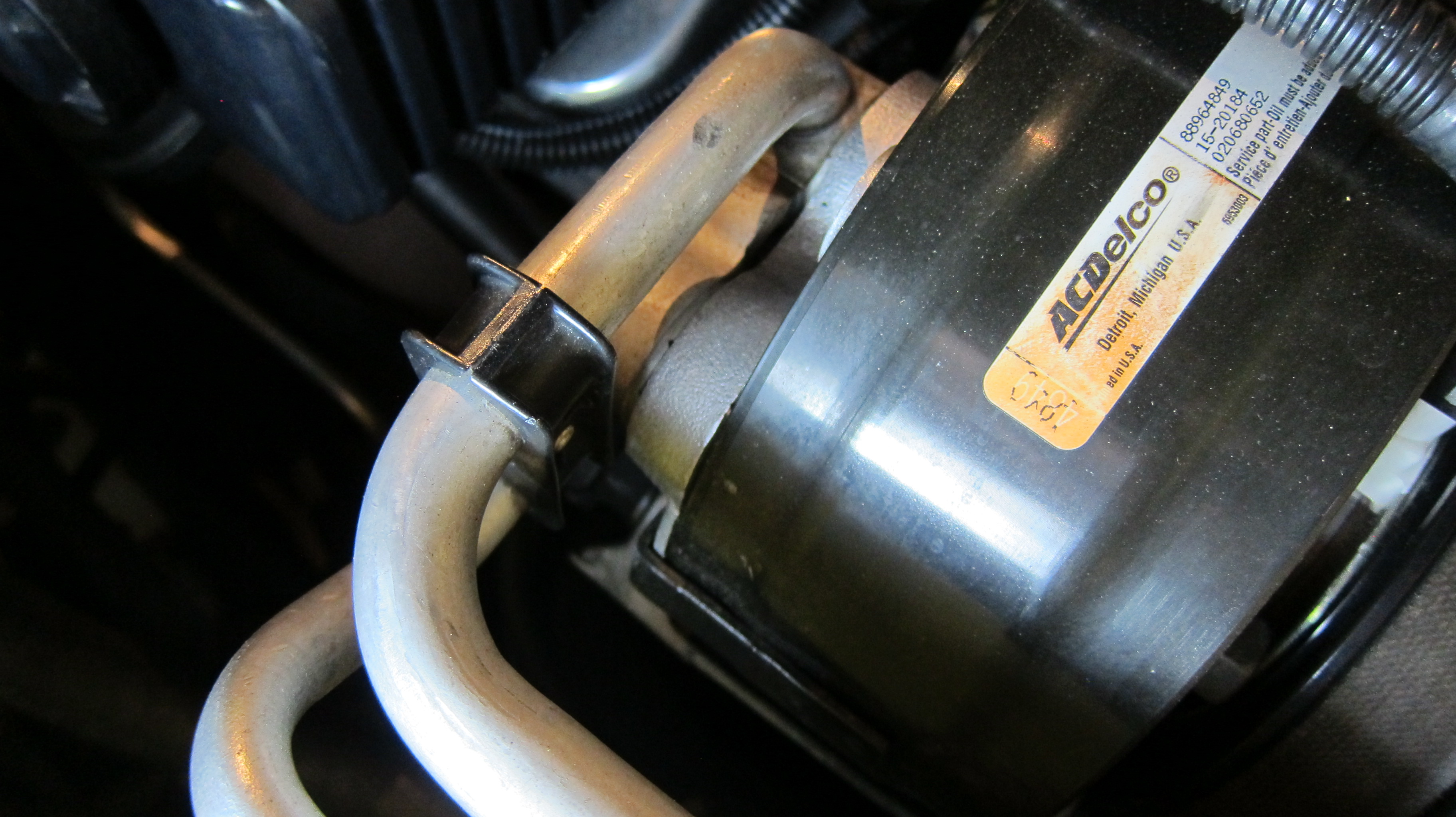

Reid, hoping you can help. I have an 84 bird that had belts. Converted to a serpent system from an 89 chev 2500. The ac compressor went from left(drivers side) to the right side. I hear talk of changing out the office tube, I cannot figure where it should install. Can you help me with location? Thx Byron
#2 is pointing at the high side schrader valve. Just after that, the metal line bends down. Right where it bends down, you can see the spot where you'll need to use a wrench to open that up. Actually, the picture has a zip tie right where you need to loosen that nut. Once you remove that, the orifice tube will be sitting in there straight up and down.
A pair of needle nose pliers helps to get it out. Pull and twist gently and it should come out. Pay attention to which way the old one was installed and replace with a new one.
Obviously, the system has to be free of refrigerant before opening up that line.

Reid, thank you for your response. It is very much appreciated. I don't think I ever considered that location. This again, regards, byron

-Bob
Getting ready to charge tomorrow. I have new compressor,hoses, accumulator,and orifice tube. Evacuated system down to 28hg. It held all night. The new compressor came with the Freeze oil in it.
Question is..how much refrigerant will this system hold? And do I need to add any more oil?. I bought the 30# Cylinder of R134 and the scale.
Any help would be great!
