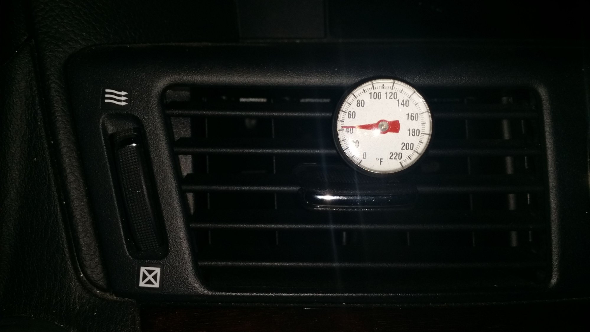

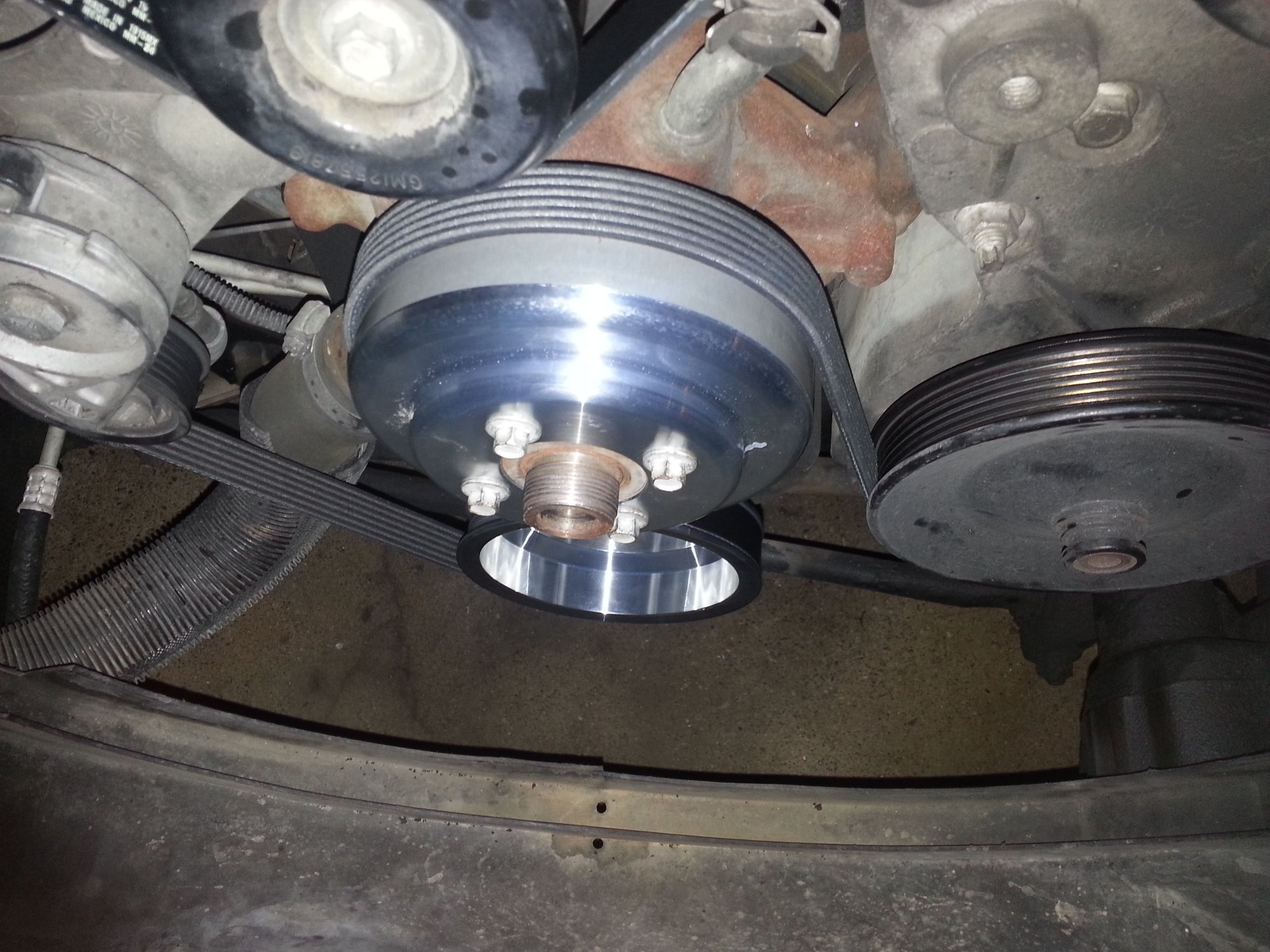

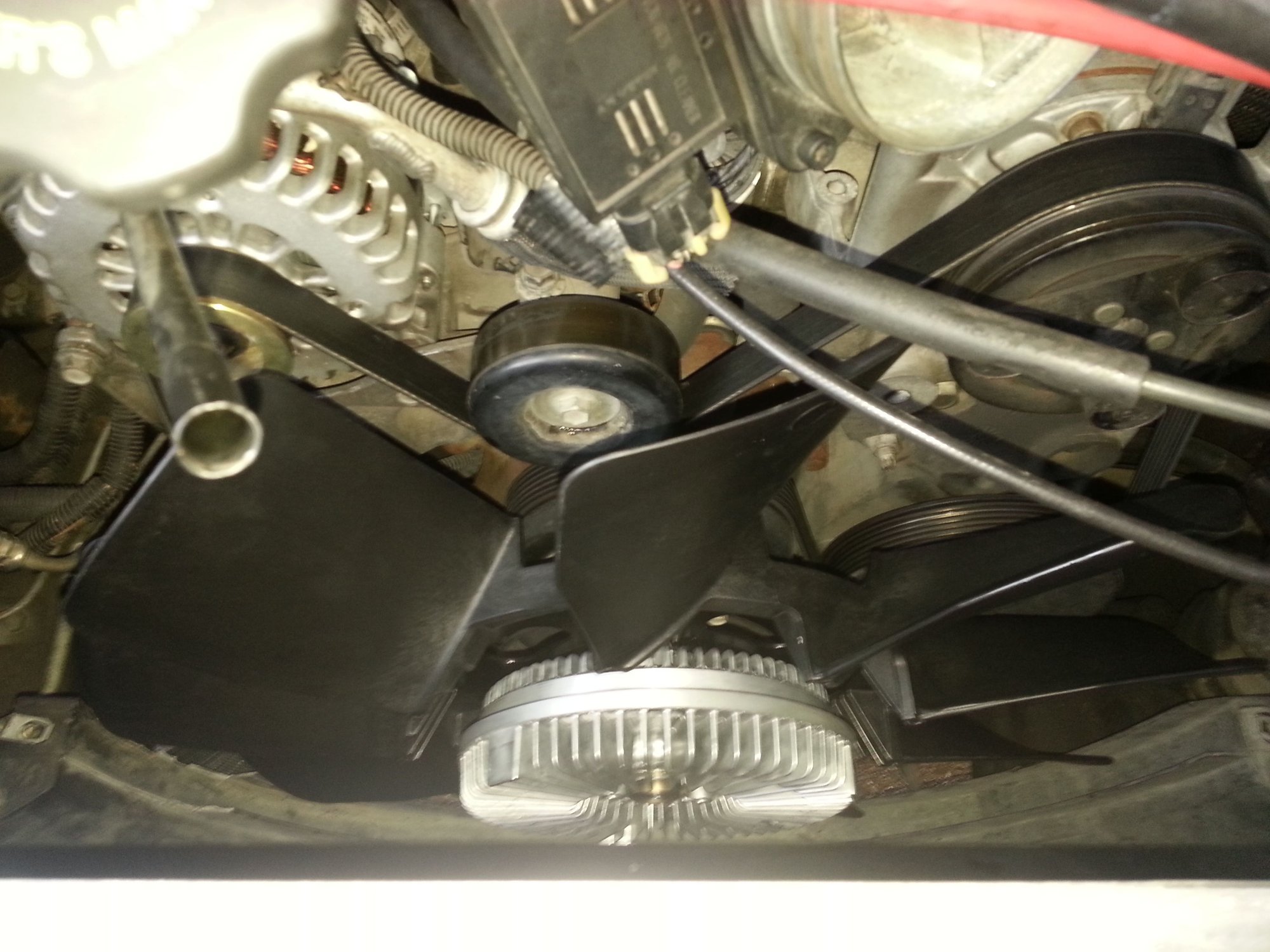

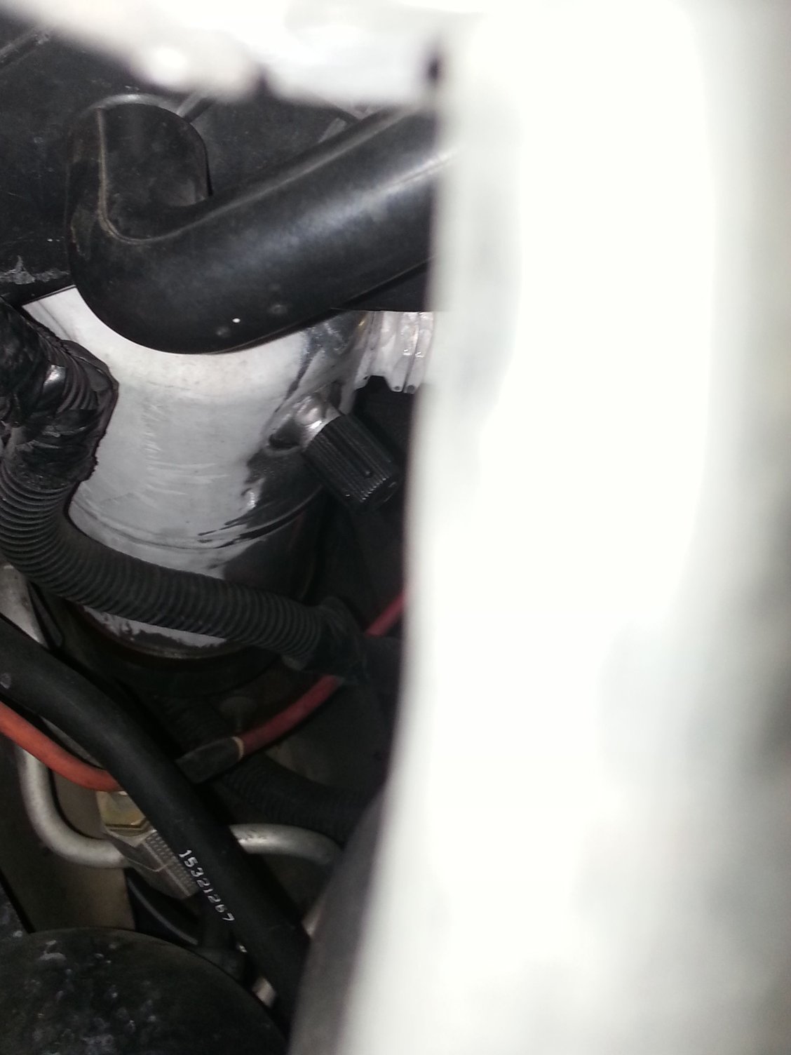

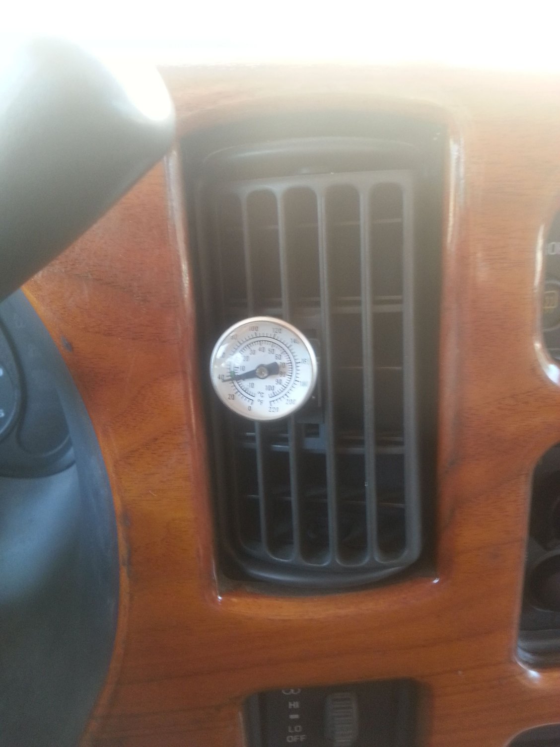

This is the kind of temps I was getting AT IDLE with R152a in a R134a system. Used the smaller red ford orifice tube in the front and untouched expansion valve in the rear. I should also say the Express van is reaching those vent temps with a 25% underdrive crank pulley and a mechanical fan from a Duramax. I had to change the cycling switch to am adjustable one and actually increase the cutout pressure to keep the evaporator from freezing.
The M56s has a high mileage untouched system. I added exactly 1 can of duster air from a 3 pack that I carried home inside the car, FWIW for you flamability nuts. Yea I carried the package home with 3 times the volume of what is inside the system inside my car.

Duracool is very close to what I ran in my Dakota for several years. I had a brew of 50/50 Isobutane& Propane. That truck would freeze you out of it on the hottest day within minutes.
So mixing the 134 and 152 wasn't a problem for you.

Re: RedTek R-12A status 9months later
An R134A system was designed to work best with inefficient R134a refrigerant. I could see it working a lot better with the R152A. And yes-you are right. It is a Bunch of BS about the R152A being flammable.
How much R152A did you charge the system with, and what was the original capacity of the system with R134A?
IIRC the duster cans I used are about 10oz each.
The 2011 Infiniti M56S has a 1.21 lbs system. ICE COLD with one 12oz can. The Express van is 4.25 lbs. Took about 5 cans. You probably lose 1-2 oz out of each can. I watch the pressures and feel the temperature of the return line coming out of the evaporator. Once it starts to get cool to the touch I slow the charge rate substantially and creep up on the correct charge. Its not an exact science. So looking at the measurements the Express van was about 75% R134a charge and the Infiniti about 50%. Infiniti might have worked better with more refrigerant but it is an orifice tube system and the low side line was in the 34*F range at idle. High side pressure was noticeably lower on both systems than R134a.
