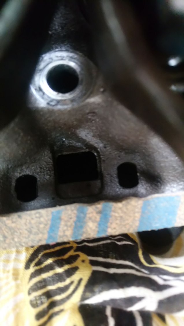

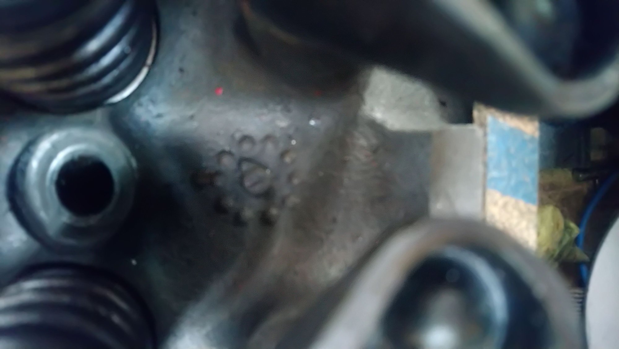

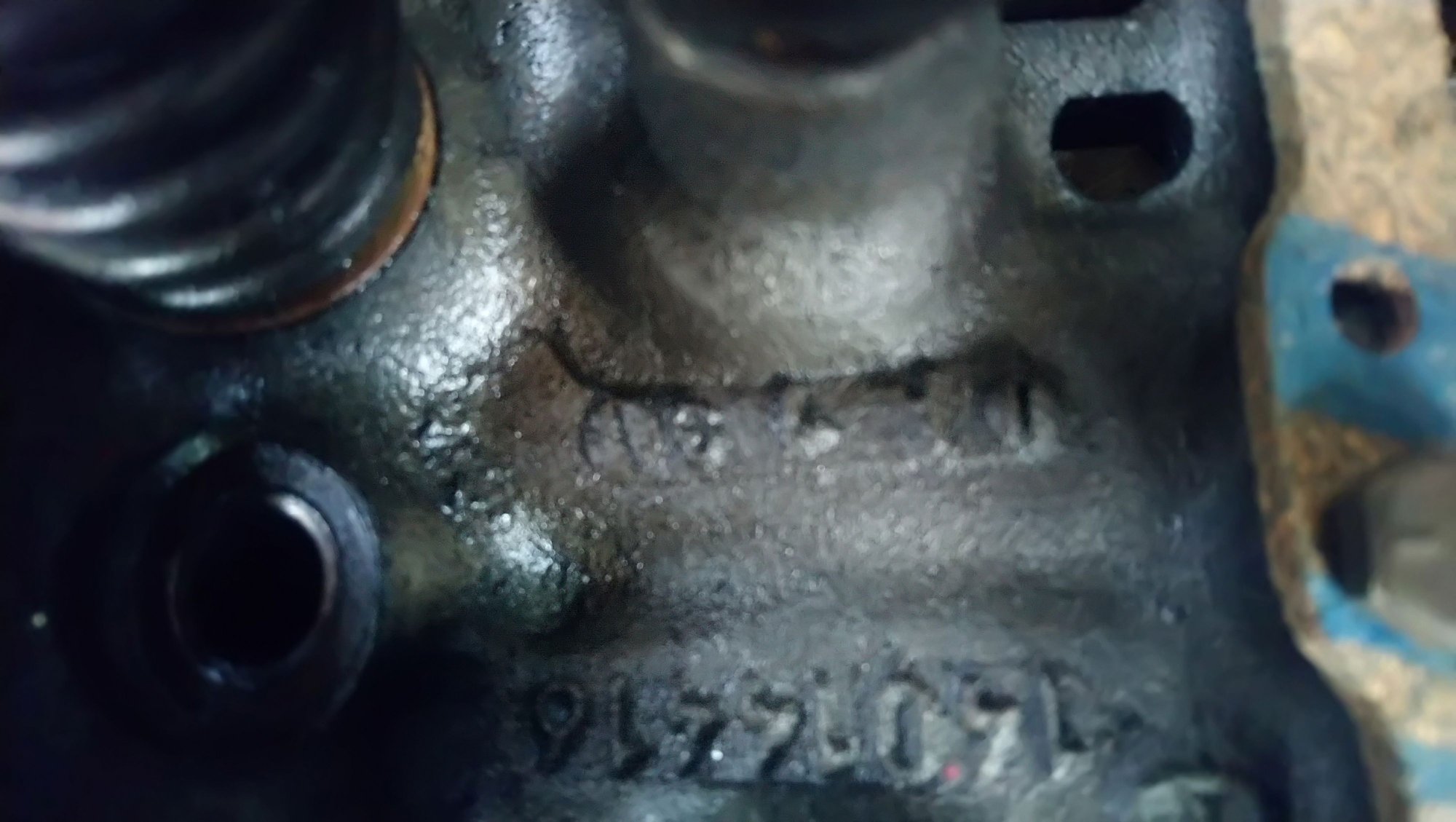

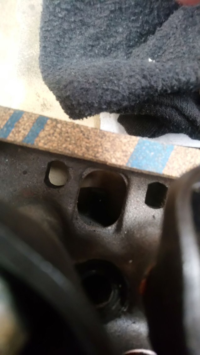

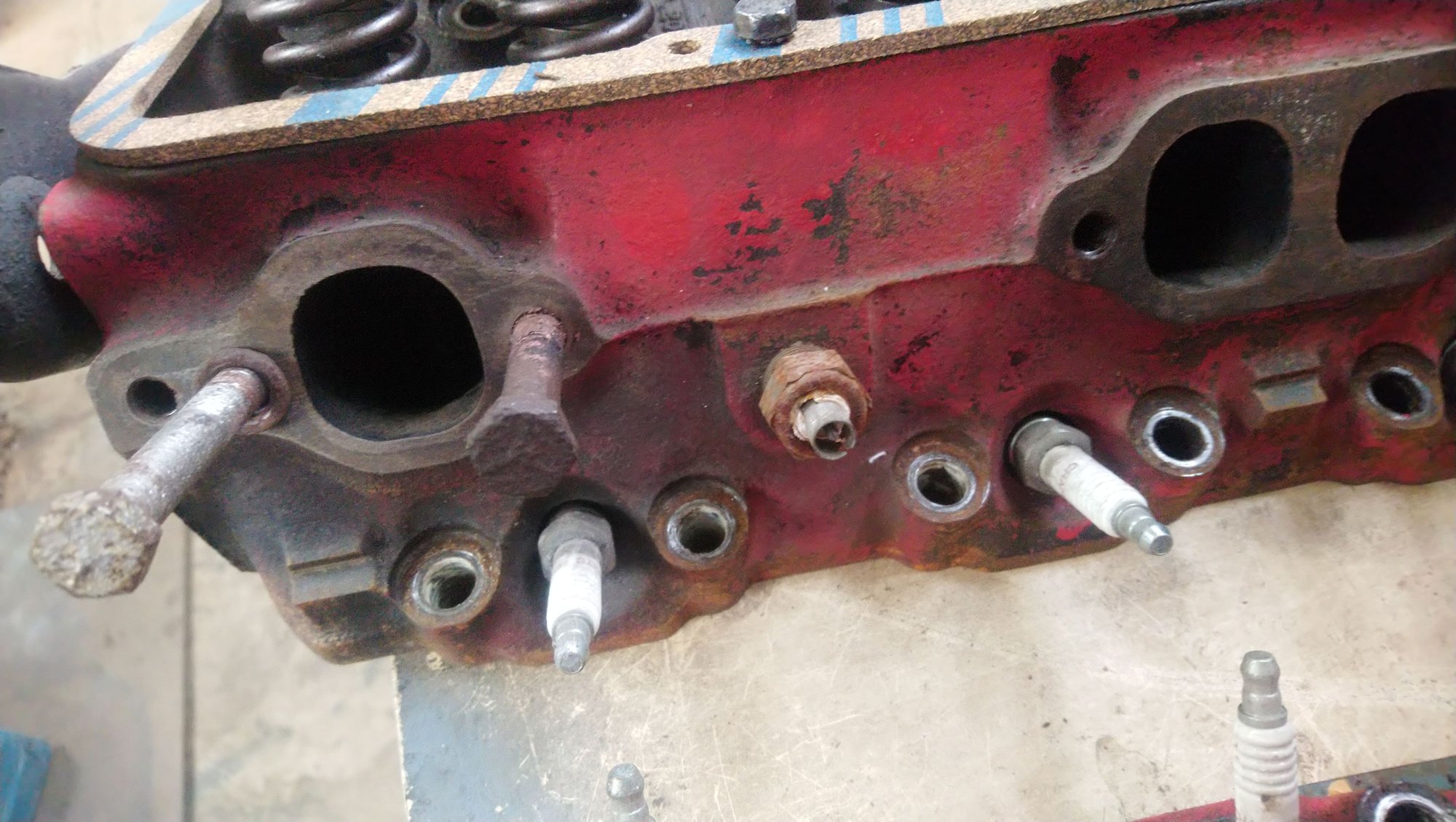

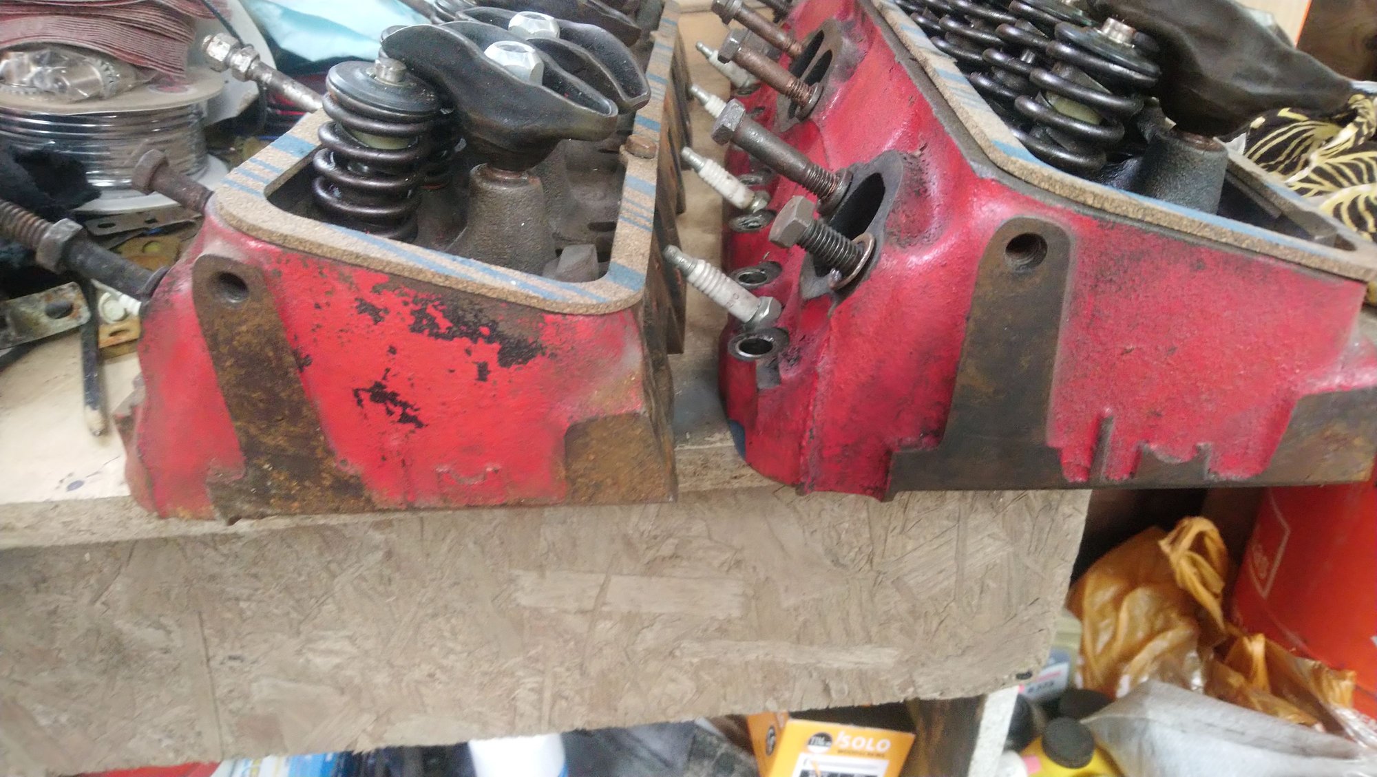

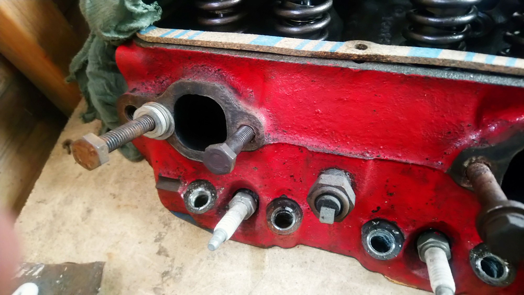

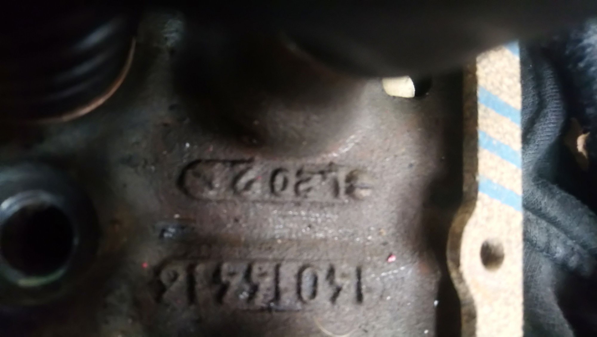

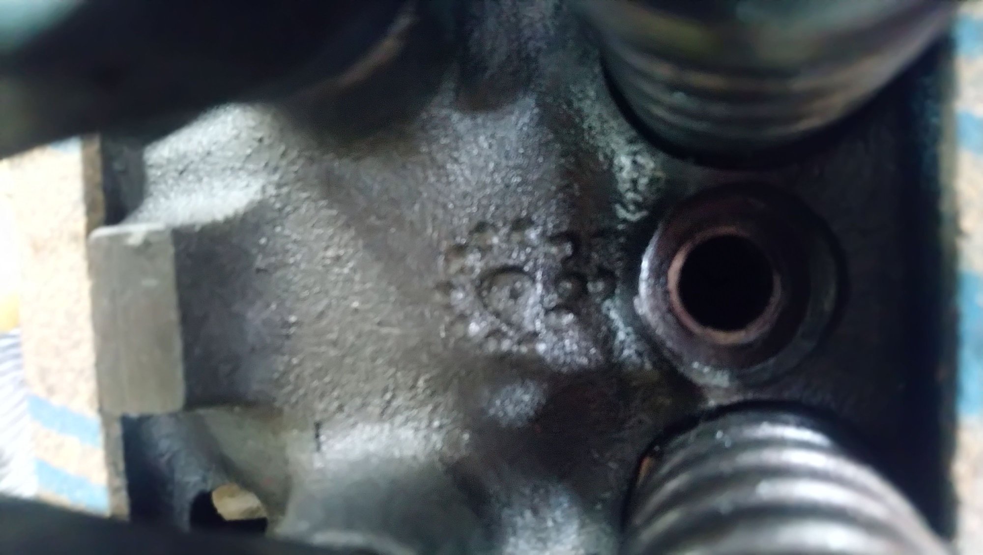

Looks like you are correct about the heads, one looks older than the other, 2mm difference in height they are both 416's but one is different, oil galleries are different a little, date stamp is different I don't have any idea by how much as I don't know ​​​​​
at the dots work out to, check out the pictures
This is the passenger side head
Drivers side
You can see the difference between the oil hole on this head compared to the next pic

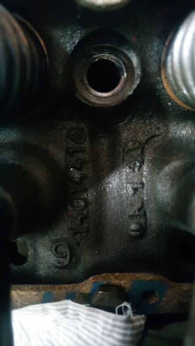

Looks like you are correct about the heads one looks older than the other one in the picture you can see the difference in the oil passages as well as the older looking head is 2mm higher in deck height than the other, they have the dots to date them but I don't know what they mean, check out the pictures
As you can see they are both 416's but oil passages are different

They look the same height to me. Really, pretty much identical in every way, subject to typical production-line variation. Neither looks "older".
Not sure what you mean about "oil passages"; there are no oil passages in small block Chevy heads.
The casting date is only clear in one of the photos: it's L202. That stands for the 20th day of month L (the 12th, Dec: A is Jan, B Feb, etc.), in a year ending in 2. Therefore that one was cast on Dec 20 1982. So it, at least, is not original to the car; 82 vehicle production would have ended in early July 82 so that the first 83 cars could be built, shipped, and stocked in dealer showrooms on Labor Day weekend. Engine castings for the 82 model year would have been completed by around April 82 so they would have time to "season" aka sit around outside in the rain and sun for acoupla weeks, then be machined, then shipped to an engine plant and built into a motor, then shipped to a vehicle assy plant, then installed in a 82 car by early July 82. The other one I think ends in 3 but it's really hard to tell because that part of the photo is out of focus, so if that's true, then obviously it's not from 82 either.
They look like different colors to me; the one looks Chevy red-orange, the other Chrysler red, although they might have been the same at one time and just have faded differently since then. Neither color is original to the car. Heads and block should probably have been a medium dull slightly greenish blue. Although they might have switched to black by then. The color changed from red-orange to "corporate blue" in about 77 or so, then Chevy introduced their own blue in about 80, then they went to black in about 82 or 83. I know my 83 was black but I can't recall what 82s were.
The connector with the blade is the temp gauge sending unit. The one with the round, sort of coaxial looking, connector is a fan switch. The temp gauge sending unit belongs in the driver's side head, so if you don't want that other just ... being there ... anymore, replace it with a 3/8" pipe plug. The heads themselves are the same on both sides so it doesn't matter which one goes back where.
