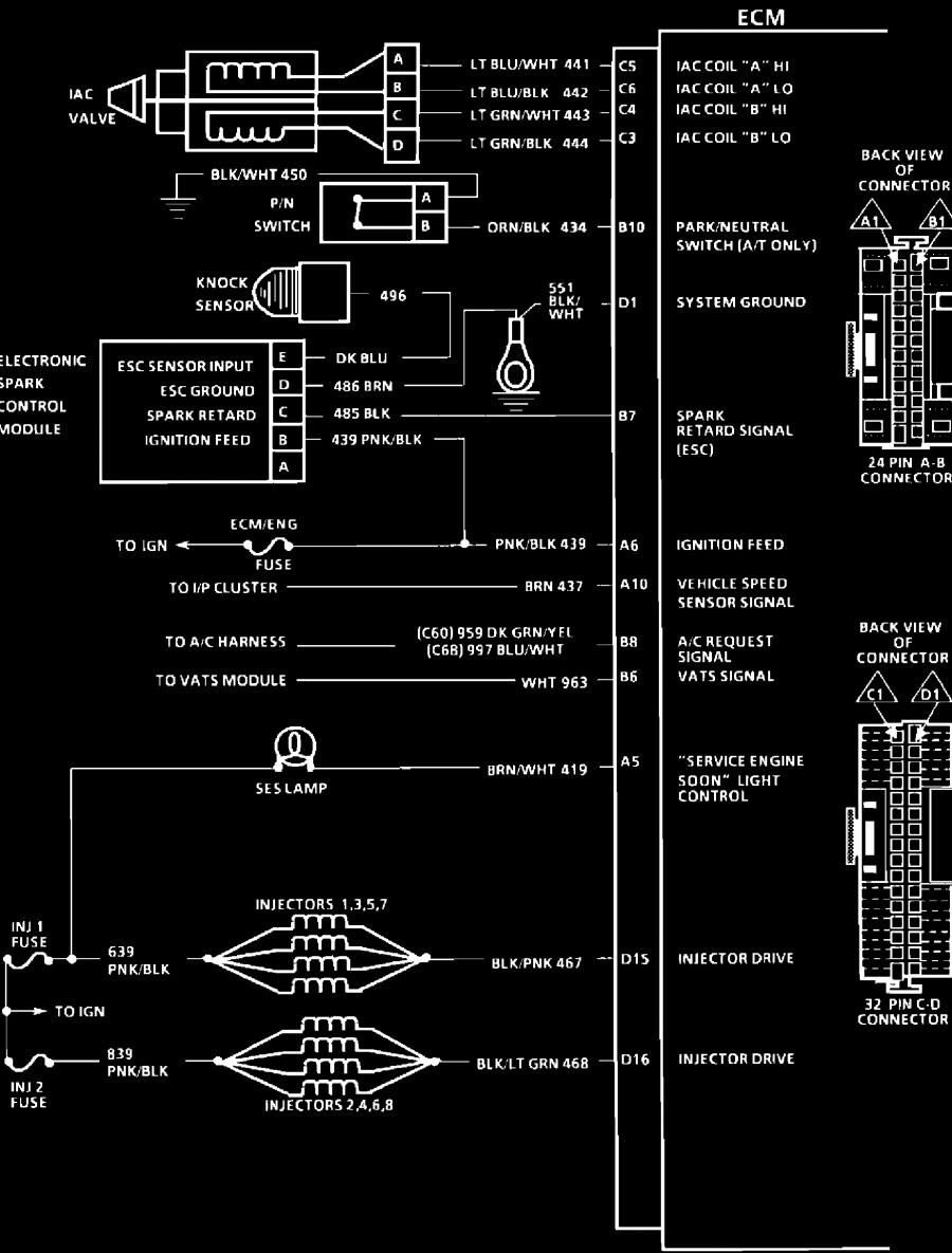

I have a working tach.The voltage drop only occurs at idle when the idle goes from its cold idle around 750 rpm in drive with foot on brake to the normal 550 rpm. I think the problem is that when you have the air conditioner on the computer is supposed to boost the idle to 750 rpm. My car isn't doing that. What I wonder is if there might be a relay or something not working.

B8 is ac signal wire. I think it goes to the ac high pressure switch.
12v applied rpm goes up 50rpm or so.
