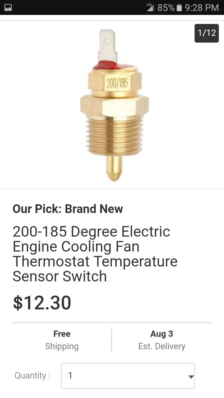

I mentioned this seller in the product review forum, but I may as well add it here.
Used this seller's switch, and so far it's working great. Well priced, with a wide range of fan on/off settings to select from in the 3/8" NPT selection.
https://www.ebay.com/itm/ELECTRIC-EN...F1IFUggtY1vF_g

Dude.
Thanks for that link. I spoke with FOUR different "Professional Parts People" at TWO different stores looking for a cooler temp fan switch.
come the @#$% on! It's a SMALL BLOCK CHEVROLET. Are you telling me that there is NOTHING on ANY car that will screw into a Gen1 cylinder head? A van, a truck, an El Camino? A Monte Carlo, Caprice? OMG YOU SUCK! Give me that parts computer lol
Come on ol boy, i'll even switch pigtails if I gotta, don't care! It's a Chevrolet, it ALLLLLL interchanges...You're fired. I'm going to eBay. SUCK IT!
None help available. They ALL told me to "go online". Fark! I was trying to avoid that. I AM HERE. Cash in hand, and you a-holes wonder what brought about the death of "brick and mortar"?
Wtf you mean it won't tell you the temperature? The Camaro part said 212°...

Thanks again @MANIAC Z. Which one do ya'll think would be the best choice to run with a 195° thermostat? 200°on 185° off? I think that's what i'll get.
I ended up paying 12 bucks.
