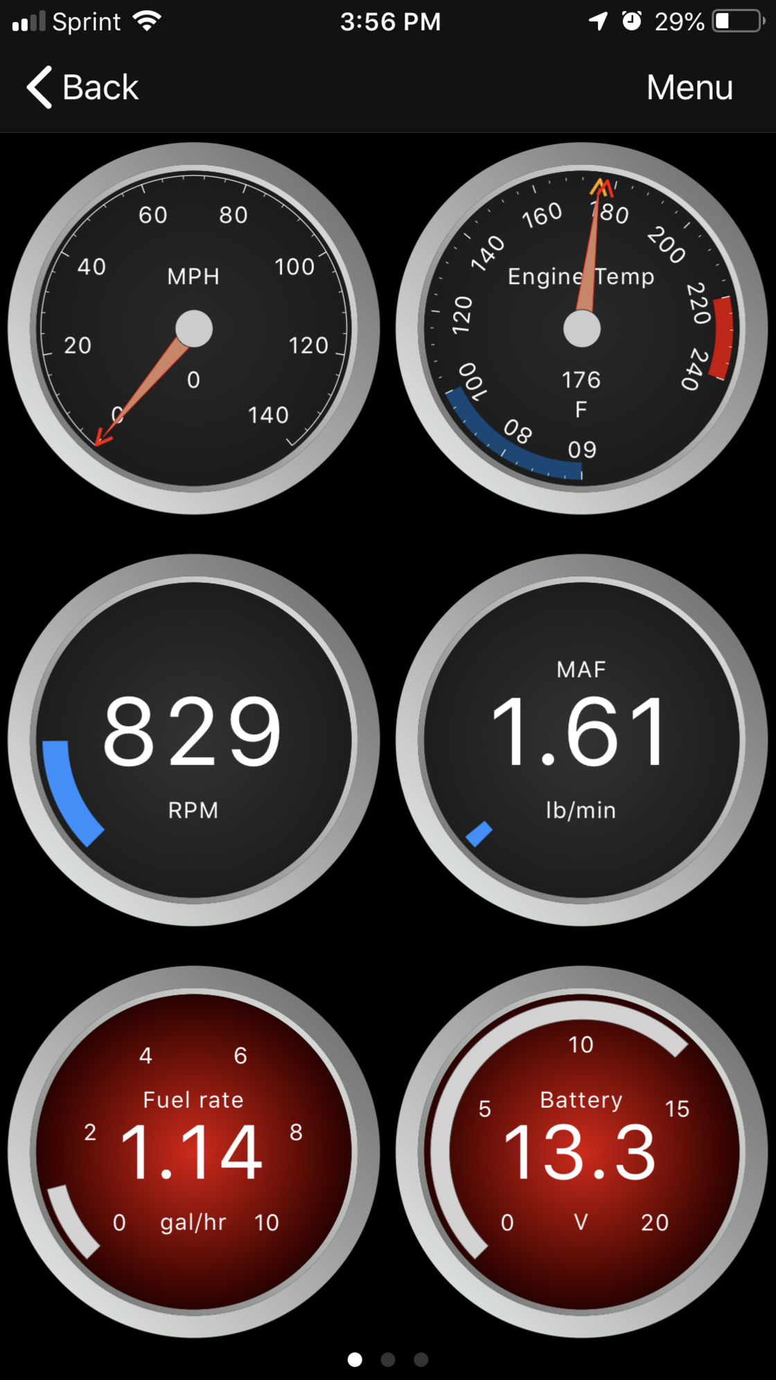

My Ls swapped IROC would get up to 235 while idling and AC on in the current Texas heat, never boiled over but I did not like it being that hot. I verified the temp with my OBD FUSION APP and an IR thermometer. The solution was to replace the stock radiator and single electric factory fan with a 3 row Champion aluminum radiator and a 3000 cfm dual electric fan unit by Flex a lite. Now the car never idles above 180
