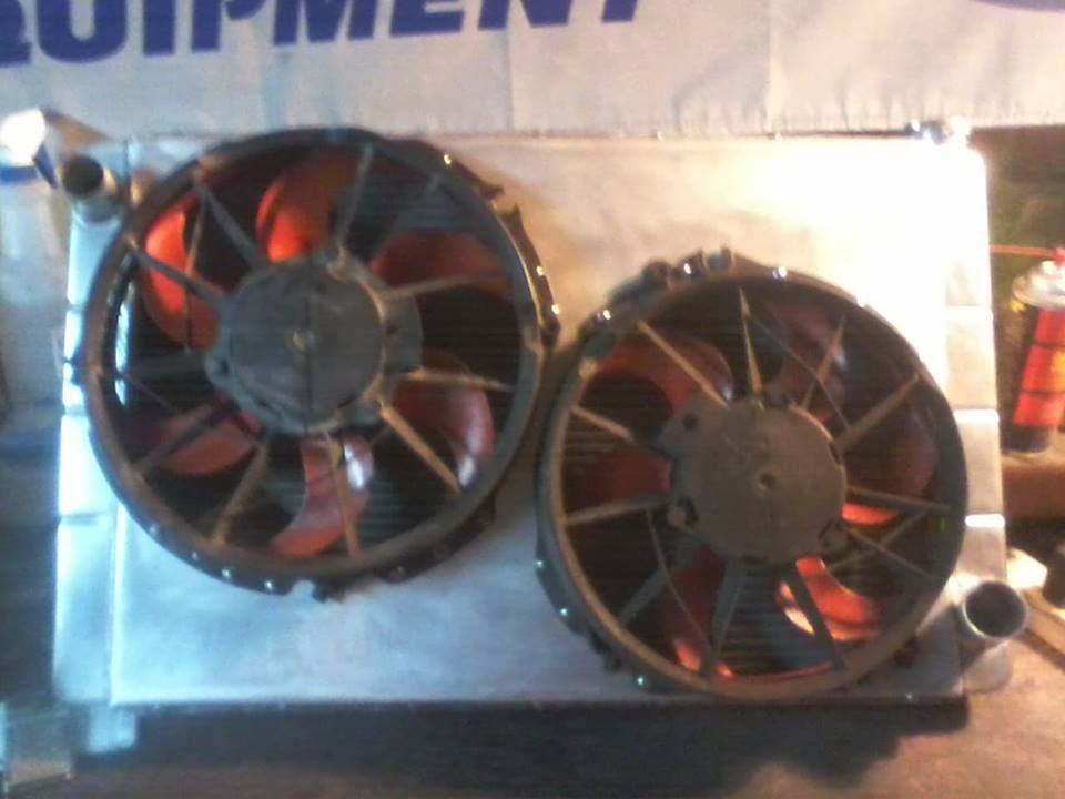

I'm running taurus fans. Will run 170F all day long in the florida heat. Drilled a couple 1/8" holes in the edges of the thermostat to let a lil coolant circulate all the time. Check your lower hose when the thermostat is open. Rev the engine up and watch the hose. I had one sucking closed before. Went with a ribbed hose and that stopped the problem. You have a shrou for the fans installed?

No shroud. Just stock dual fan setup. Ok, those Taurus fans are sure getting recommended here. Lower hose is OK, not collapsing..

Ive got two spal fans, push/pull set-up.The secondary fan is for the AC, but has a adjustable relay to turn on at 208/210, incase. Main fan is ECU controlled, on at 205.The temp never reaches high enough to cause the secondary to trigger.Temp drops back to 188/190.Takes about 12-14 minutes for it to trigger on again.Stock stat is 187 open.I also made a shroud for the main fan, as this helps it pull more air thru the radiator when not in motion.
