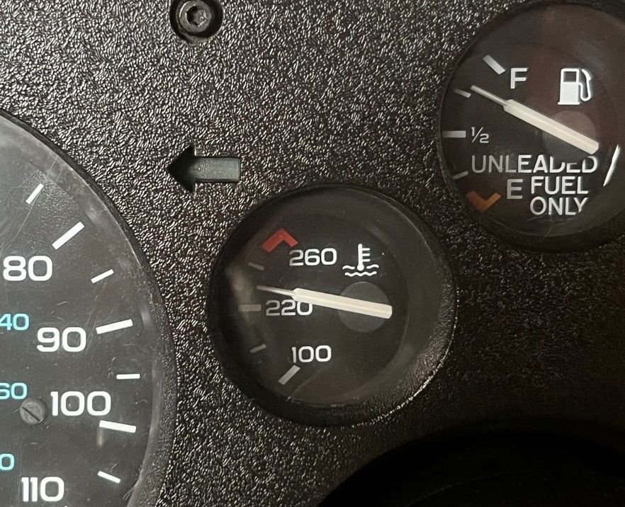

It's routinely over 100 here and the stock single fan can't keep up, especially with the AC running. I think the factory shroud for the single fan is completely inadequate since the sides of the radiator are just open and no air is flowing when idling. Has anyone fabbed up a shroud for the stock single fan? I'm trying to get ideas for what I want to do.

The single fan works fine. Worked fine in my 83 when I lived in the deep South. Still worked fine after I put a 400 in it; 100°, 100% humidity, sun on the T-tops, A/C blowing cold. VASTLY more stressful than CA. Or more specifically, when I LIVED in So CA (N SD Co), later on.
Can't speak to "Vortec" or "383" as such. Can't see how any of that would make any difference in any case but w/e. Also can't speak to the overall condition of your parts, the correctness of your tune (inadequate ignition advance or poor fuel tune either with a carb or FI will make a motor overheat RUTHLESSLY for example), and so on. But as far as the "system" itself being "adequate", no problem there.
A shroud is unnecessary and in fact counterproductive. When the car is moving faster than around 35 or 40 mph, more air is forced through the rad by that, than the fan, by far. Adding a shroud actually DECREASES the cooling capacity of the system.
I suggest you focus more on making your car WORK RIGHT as opposed to "improving" that part of it. Things like, a truly GOOD fan motor (not just "it spins"), good wiring to it so that the full electrical system voltage reaches it without excessive voltage drop in poor connections or corroded grounds or whatever, 60/40 or so DISTILLED water to AF ratio, good rad cap, no leaks, and so forth.

It's all too often over 100 here but my stock single fan works fine. Is your air dam intact?
Does the fan turn on at the right temperature?
Is the fan motor turning quickly with plenty of torque to get it going?
Have you cleaned out any and all leaves, etc in front of the radiator and/or AC condenser?
All things Sofa mentioned. It should work just fine if functioning properly like it was designed to

The car is immaculate, a fresh rebuild. Everything in the cooling system is brand new except for the fan and the car runs great. I went through the harness when I rebuilt it and cleaned all the connectors and patched anything that looked frayed. It never overheated in the Winter or Spring, just when temps started creeping above 95. The radiator is a three core aluminum way beefier than the stock radiator. Even when the car is rolling it will overheat to the point of boiling over.

The stock single fan pulls PLENTY of air compared to lots of other fans out there. I thin its due to its size and what not... I just swapped to dual LS fans cause why not....They seem to cool slightly better than the single. but honestly the single cooled very well but was kinda loud. but I knew it was working.
The dual TPI fans were not that good.... I think its because how only one turned on then the other turned on at a certain temp blah blah etc... The LS fans are more less the TPI fans but with a shroud and stronger motors..... Even the blades are the same.
It kinda sounds liek it may be something else, but maybe your single fan motor is maybe old and weak.... its turning but just not turning fast enough.
Depending on what single fan blade you have, you can throw on a delco LS fan motor.. those spin a bit faster than the old motors and bolt right into the 3rd gen fan housing...both dual and single....... As far as I know, the stock 3rd gen sigle blades wont work on a delco motor... but I found that the single blade from a 93 cutlass ciera would bolt on and fit in the 3rd gen...
Other motor brands like Napa might work with the 3rd gen fan blade but I do prefer delco.

I've been looking for a good replacement but everything I've found so far pulls too much amperage. The fan motor was new in 2008 and I honestly don't drive the car that much. It probably has less then 300 hours on it. Do you have a link for the Delco LS fan motor? I did a search and there are too many results.I appreciate your time!

You can look on rockauto,under 2002 camaro 5.7
The part number for the delco motor is 158404 ... I see this on amazon as well. The problem with this motor is you'll see the little integrated hub / spacer where the fan blades would sit. Unless the fan you have has an indent for this...., it won't sit properly. The TPI, newer Cutlass Ciera single fan and LS1 fans have the integrated indent....someone on another forum claimed there was a separate part number for delco motors that don;t have the spacer, but they were never able to back it up with a part number..... and I personally have never been able to find one even for the older non LS fan motors... they all have that integrated spacer...
Four seasons makes one that appears to have the spacer as a separate piece..... ..part number 35379... Ive gotten these before and IMO they are crap compared to the Delco motors... I've had some that are out of round, and they don;t last long.....even the housing seems flimsier.... the delco ones have lasted me years.
its possible your fan motor is weak since its old but im thiking there's another issue for the motor overheating, but checking the fan motor would be a good first start!

That's outstanding info, I really appreciate your help. I'll pull the fan out again next weekend and check for the indent. I really hope that's is all it is.

No prob. Just remember to double check your fan blade to see if it has the indent before getting the delco motors...

I put the delco motor P/N 158404 in and it seems to be cooler. Today wasn't a particularly hot day, 96. The temperature gauge stayed right at where it is in the picture for most of the time. Who knows what the actual temp is with these old gauges.I was running the AC full blast. It didn't boil over but as soon as I shut it down coolant bubbled into the reservoir.
