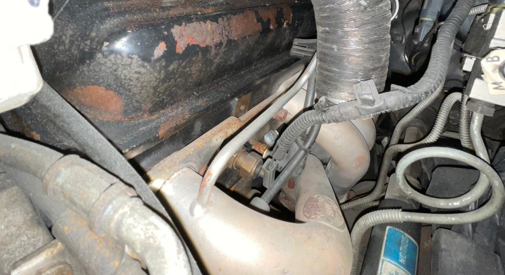

This is the temp sender from the other side, you can see the adapter on it. It has the original center bolt valve covers, so I doubt that these are heads from the 70's.

Then someone must have drilled them out and tapped them to the larger size from days gone by.
You can be sure that they didn't leave the factory the way they are now.
Even so, it's an easy fix, no matter how strange or how they got like that.

Thats the proper sender for the gauge. So maybe the original threads were stripped and then "repaired" with that adapter
Zackly.
