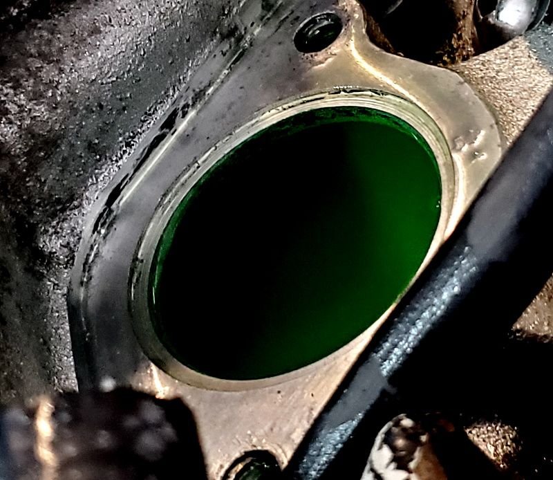

Here's the picture. Based on your description, and my lack of knowledge, I don't know if I should or not use a rubber seal around the thermostat. There is a tiny bit of sideways movement when the thermostat is in. Seems all the ones I find for the car are ones that do not have the seal.

Re: Rubber ring around thermostat
on a SBC? I've never seen a oring. The housing you have is probably flat, in which case, use a gasket
Yes, the housing is flat. I will just use the thermostat as is. The person who had it before me had a thermostat with the rubber ring in it so I wanted to be sure. Thanks you two!
