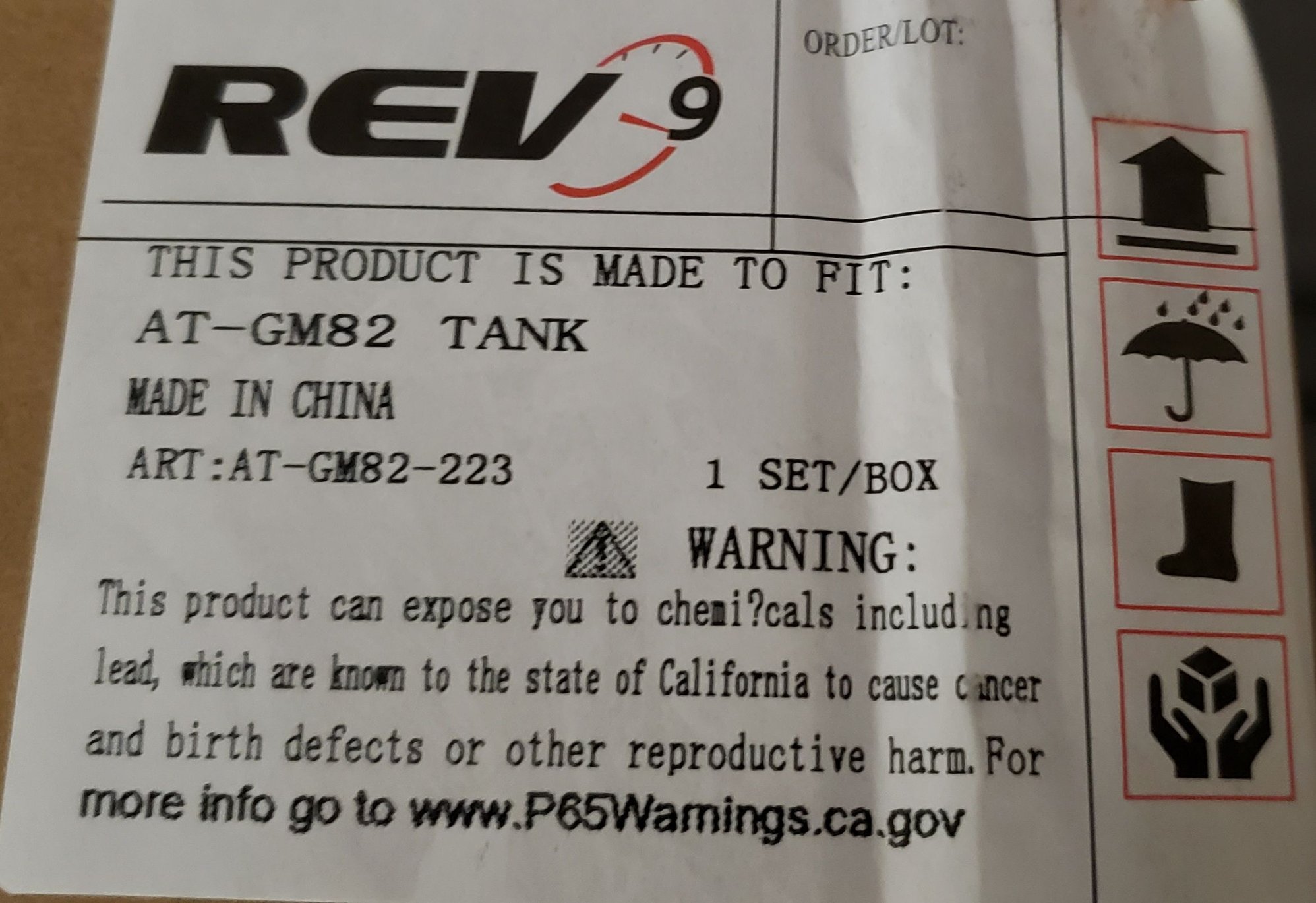

my #Rev9 Expansion tank for 3rd Gens arrived today...
AND it's made in f-n #CHINA 🤬
Needless to say this CCP Crapola from Rev9 is going back.
I will never buy anything from Rev9 again.
https://rev9power.com/aluminum-coola...2-3rd-gen.html
