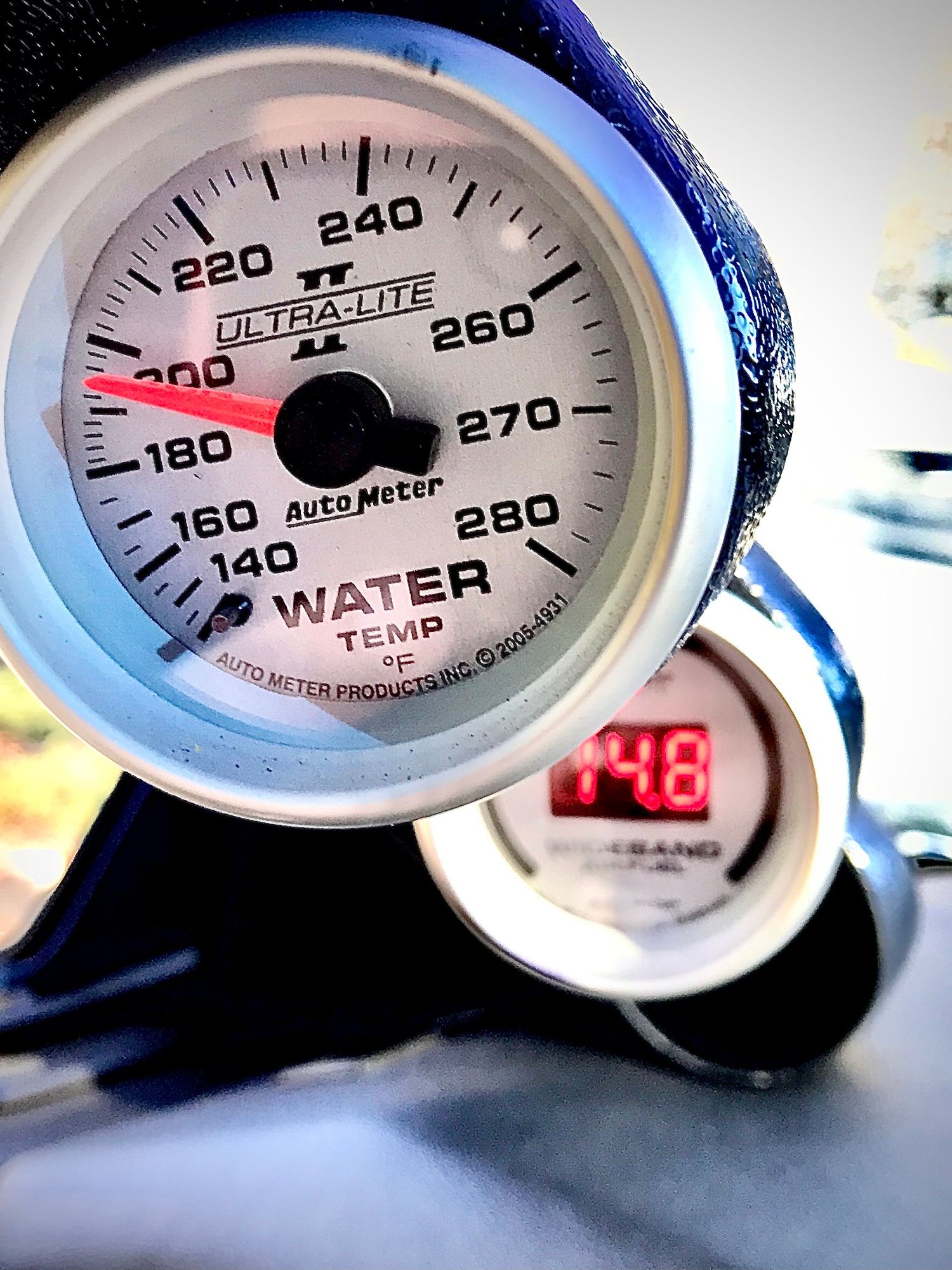

Update, I installed new electric fans from BeCool over the summer. My car no longer over heats. The mechanical temp gauge stays steady around 195-200. If temps rise over 200 the fans kick in and in seconds temp drops down to 195. The OEM fans I had in the car previously did turn on but maybe they were not pulling enough air. BeCool #75007 - 11" dual fans, 2725CFM. I no longer have to worry about long drives.

I just wish I had changed the fans first and I would have saved money on all the other parts I changed. But they always turned on so I always eliminated them from my possible cause/replace item. Note to others, just because your fans turn on, OEM fans may start to pull less air possibly due to age/wear and tear in the fans.
