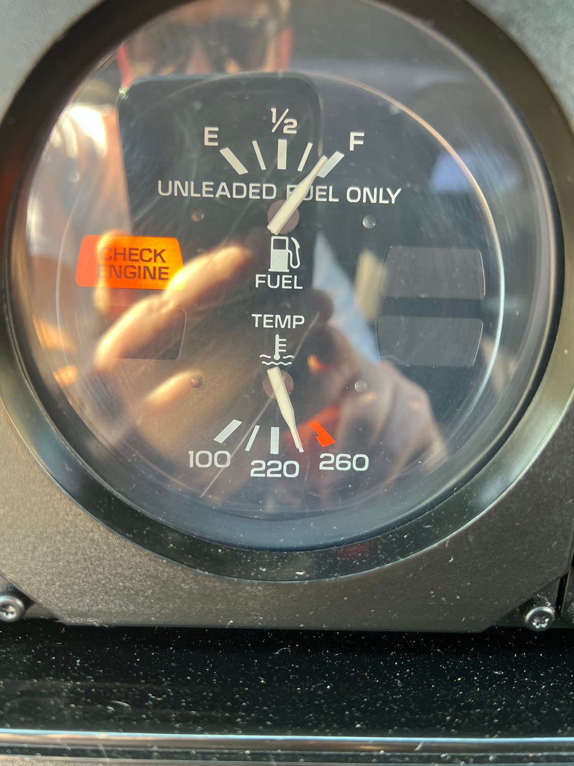

I’ve exhausted all my searching capability. I have an 82 Firebird that I recently completed a v8 swap on. The gauge works, sort of. When the car warms up, the gauge reads ~240
, but when I use a mechanical gauge, the temp is ~180. I can’t seem to find the correct sensor/sender. The sensor is in the intake manifold by the thermostat housing. Can anyone give me some insight as to what could help?

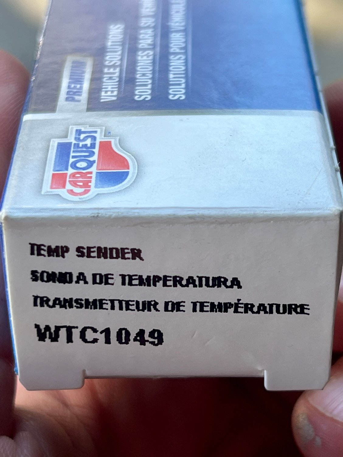

Thank you all. I bought one, just need to find a 1/2 to 3/8 not reducer fitting. Amazon should deliver them tomorrow. Fingers Crossed this does the trick. I'll update with what happens.

Had to get a 1/2 NPT to 3/8 NPT reducer, but i’m in business.
according to my mechanical gauge as well as a laser thermometer, it’s accurate.
this is an 82 V6 cluster / car with a 400 SBC and edelbrock air gap intake with the sender installed at the port near the thermostat housing.
thanks to those who helped. Much appreciated. Hopefully the info in this helps with future searches.
