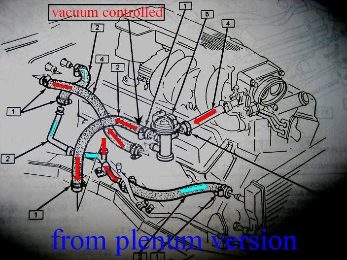

Yes, the rear manifold port to the heater core, either directly or indirectly, as you'll see in the two diagrams below.
Did the car originally come with AC? If so, then is there still a long vacuum line laying around the passenger side valve cover? If so, then that line went to a coolant divert valve.
Below is a diagram of the TPI flow, with a short hose coming off of the throttle body going to that valve first. TBI would have the hose coming from the rear port in the manifold up to that diverter valve (where the TPI throttle body hose connects), then back to the heater core as in the diagram. But that valve isn't a necessary feature, so if you don't have a vacuum line, then don't worry about it and just connect the rear port in the manifold directly to the core, as in the second diagram below.
This dated diagram below shows connecting directly from the manifold to the heater core, like you'll probably end up doing.
That diagram also shows the core's return hose going directly to the water pump instead of the radiator, as you said you've seen, which is an option for you if you don't have the parts to route it to the radiator, or simply don't want to route to the radiator. But the radiator is better because a cap on that radiator nipple isn't likely to withstand the pressure over the long term.

Yes, my car originally had A/C and a layout similar to the TPI set-up you showed, but I want to eliminate that - at least until I can get the rest of the car sorted out - to reduce the number of things I have to worry about. Personally I never liked the way GM did their A/C anyway back then: they always had that big evaporator core box (with the dryer canister bolted to the front of it) hogging all that space in the engine compartment, making it very hard to do things like change the rear spark plugs.
I like your second diagram - I think I'll do it that way. Should I take the intake manifold gasket block-off plates off both of the rear intake ports, or leave them on one or both of the ports?
I take it then that if I would want to install an inline manual water shut-off valve (to help keep heat out of the car's interior in the warmer weather) then it go on the hose going from the rear of the intake to the heater core since that is the hose feeding the heater.
