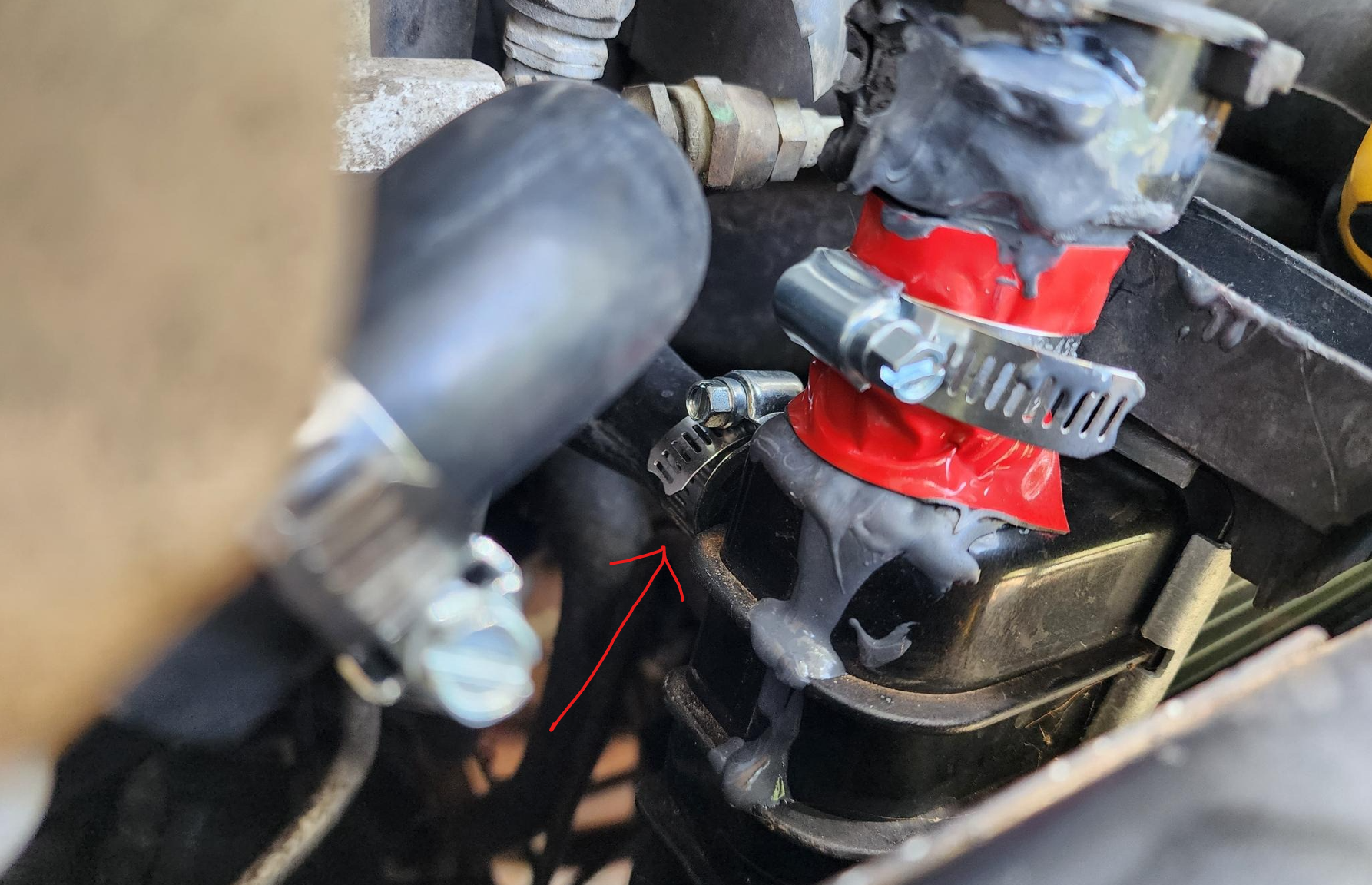

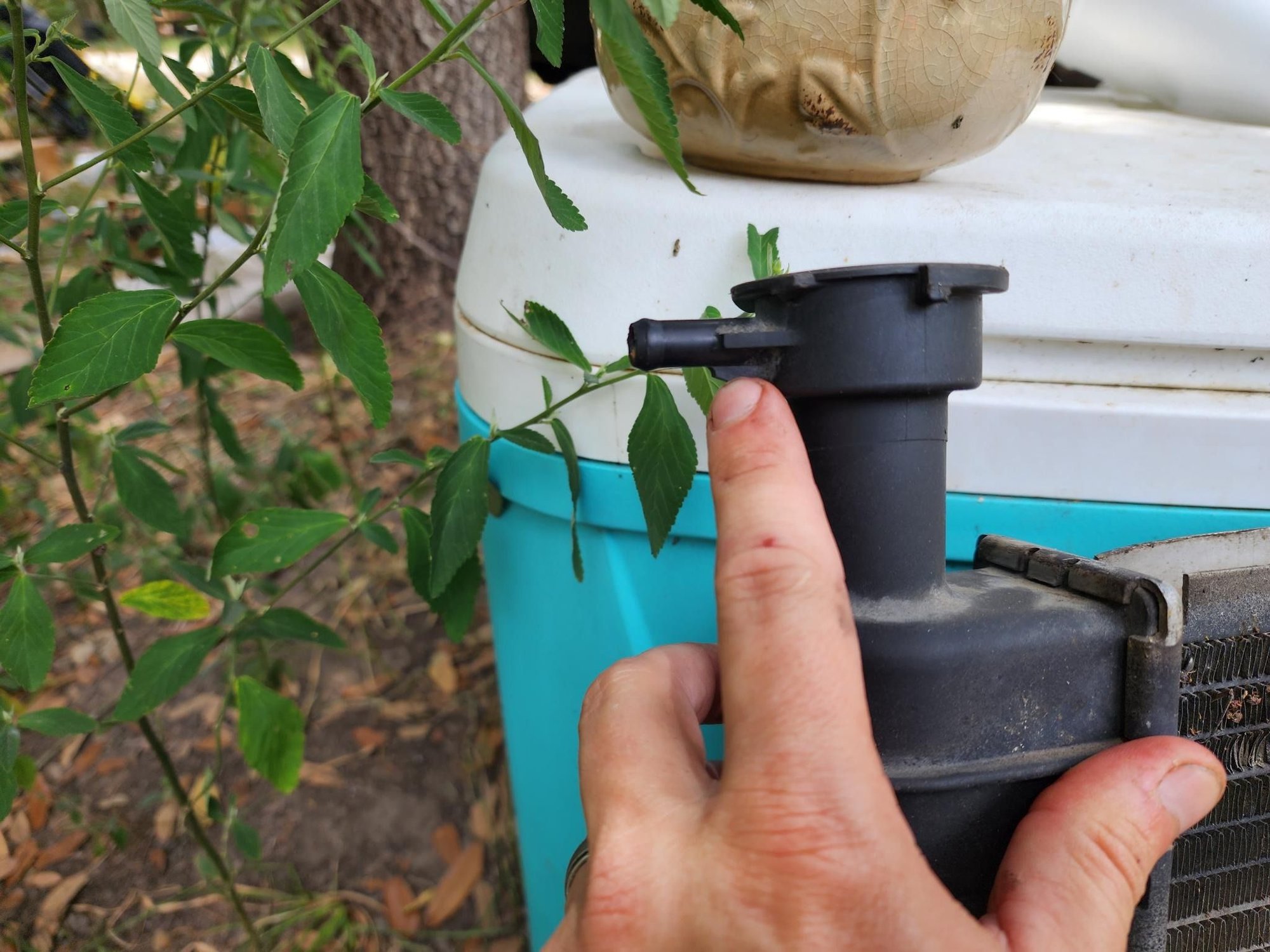

It's a 350 TBI, stock radiator setup. I replaced my cracked radiator with a stock replacement and AFTERWARD noticed that the small valve right under the cap that feeds to the overflow reservoir was snapped off. Either I did it in transit, or it came that way, no idea.
This radiator came with a plastic outlet just below that broken nozzle that I think is for a different application, because the Rad came with a delete cap for that valve and I have no hose for it in my application.
So, I decided to get a hose to fit that outlet and run it to the reservoir instead. As for the broken nozzle, I JB welded and wrapped it closed.
My question is, anyone with experience can vouch for this set up working (where I placed the hose to the reservoir)? Any issues? Also, should I just cap that outlet and delete the reservoir?
Here's an image of the old Rad nozzle that broke off on the new one, followed by the new rad and hose setup going to the reservoir.

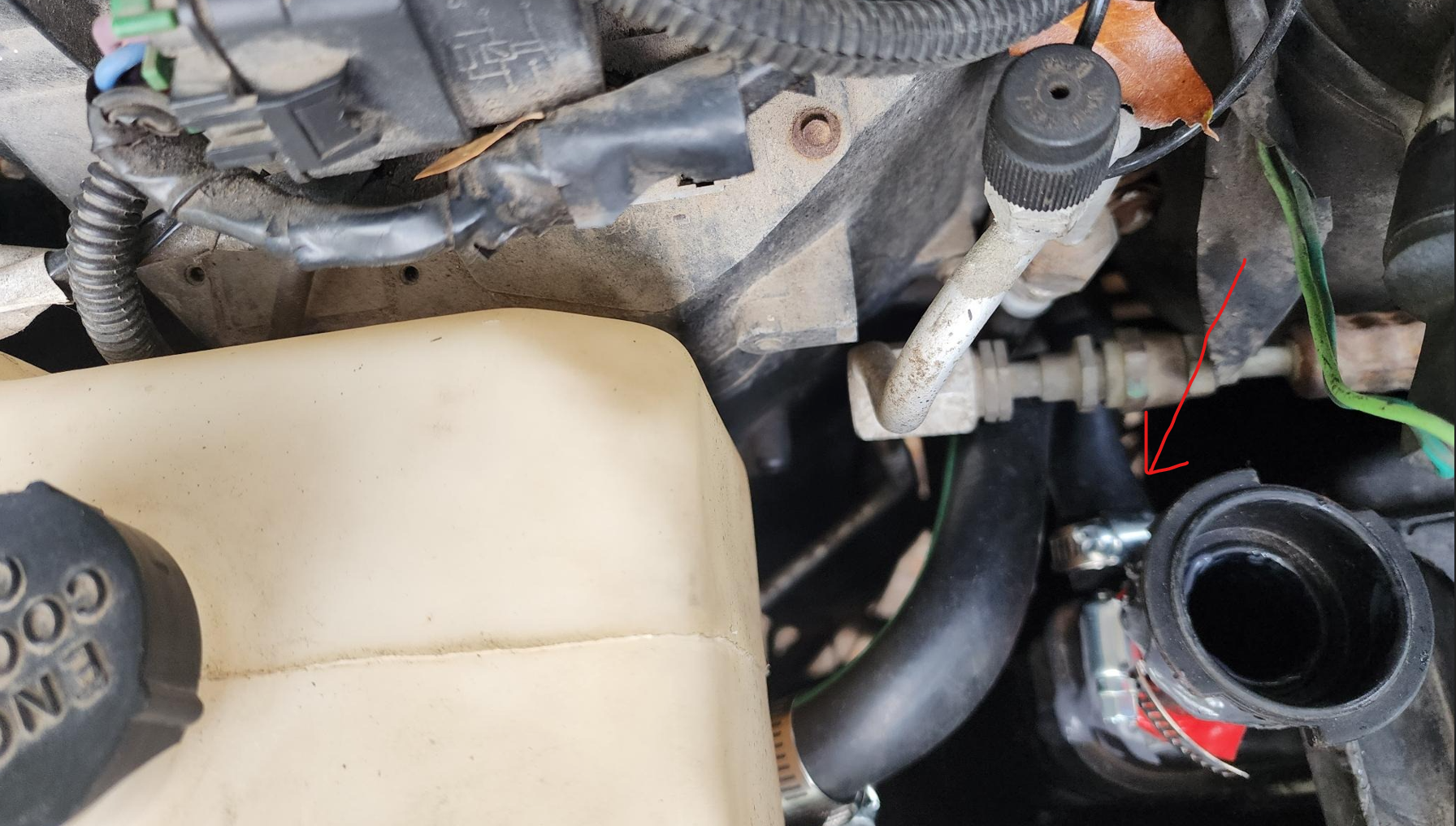

So, thinking more about the hose attached to that outlet (seen in the 2nd pic in OP and new pic attached here), It appears to be BELOW the cap seal, where as the intended reservoir outlet is above where the cap seals inside the neck. My intuition is telling me that this setup will not work, as the system will try to pressurize the reservoir, correct? Which, I don't think is meant to be pressurized.

UPDATE: Put the old rad back in. That fix wasn't a great idea and glad I didn't drive it that way. The old rad had a small crack that I JB Welded months ago and hadn't leaked since. It's in better shape than the new rad. Will reorder another rad..
