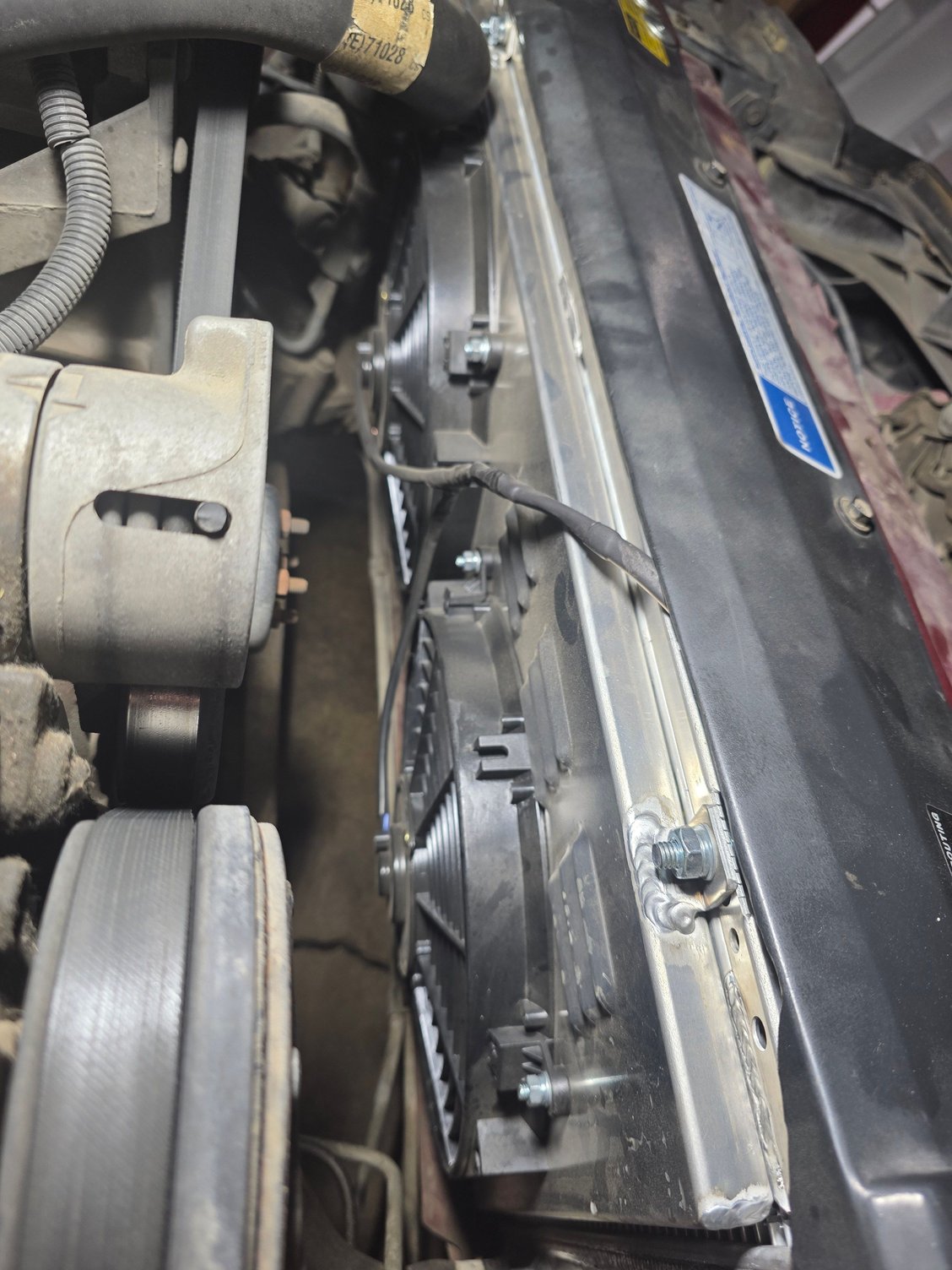

[QUOTE=242turbo;6509557]Has anyone had any experiences with these AlloyWorks radiator/fan assemblies? I’ve seen these advertised on Facebook and seem to look decent.

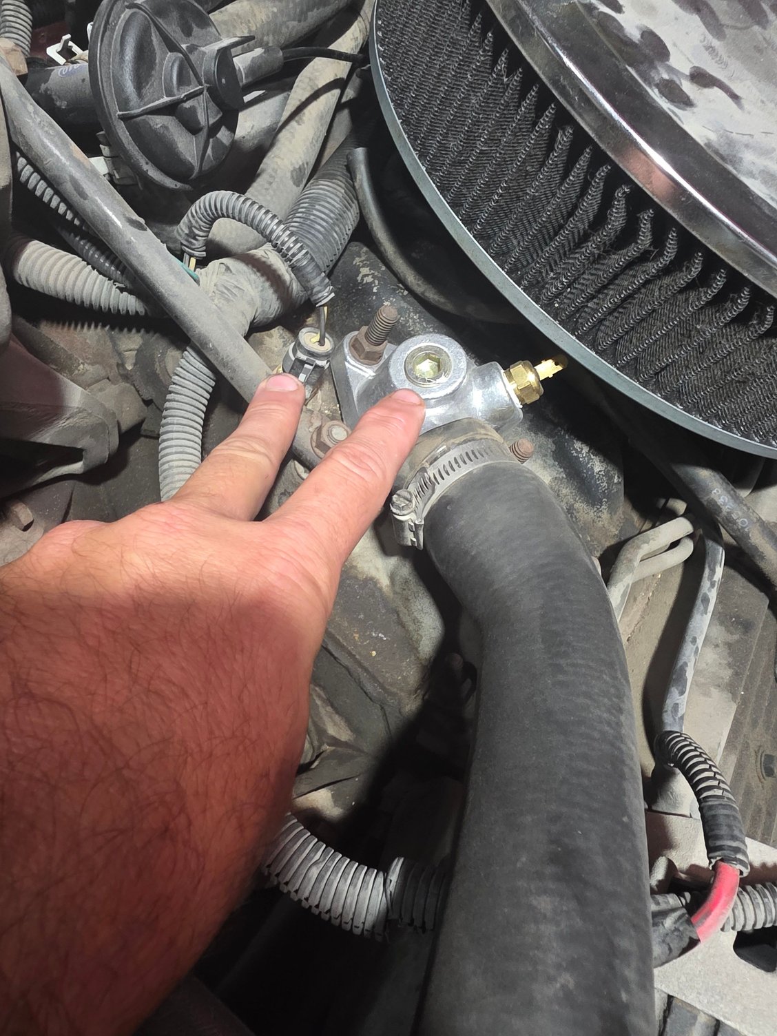

so yes, I bit the bullet. My 92 rs heritage edition, 305 vin E, tbi. I got the correct sized 3 row, dual fan electric setup. You also need to go to your local autozone and get a new thermostat housing with the extra plugs in it for the sensor needed for the fans and a 160° thermostat. This is a stand alone system, BUT, BUT, you need 2 wiring relays or be good with wiring and use big guage wires for the power as this is a stand alone system powered directly off the battery. If you just rewire these fans onto the factory harness, its triggered by a single wire relay on the drivers side firewall, and it gets soooo hot because the fan pretty much has factory speed(low) and direct battery speed(high) and it tries like hell to pull high speed on the factory wiring. That being said, you see the issues.
I also felt really uncomfortable watching my temp guage go above 220 A LOT, and couldn't figure out why. So here we go.

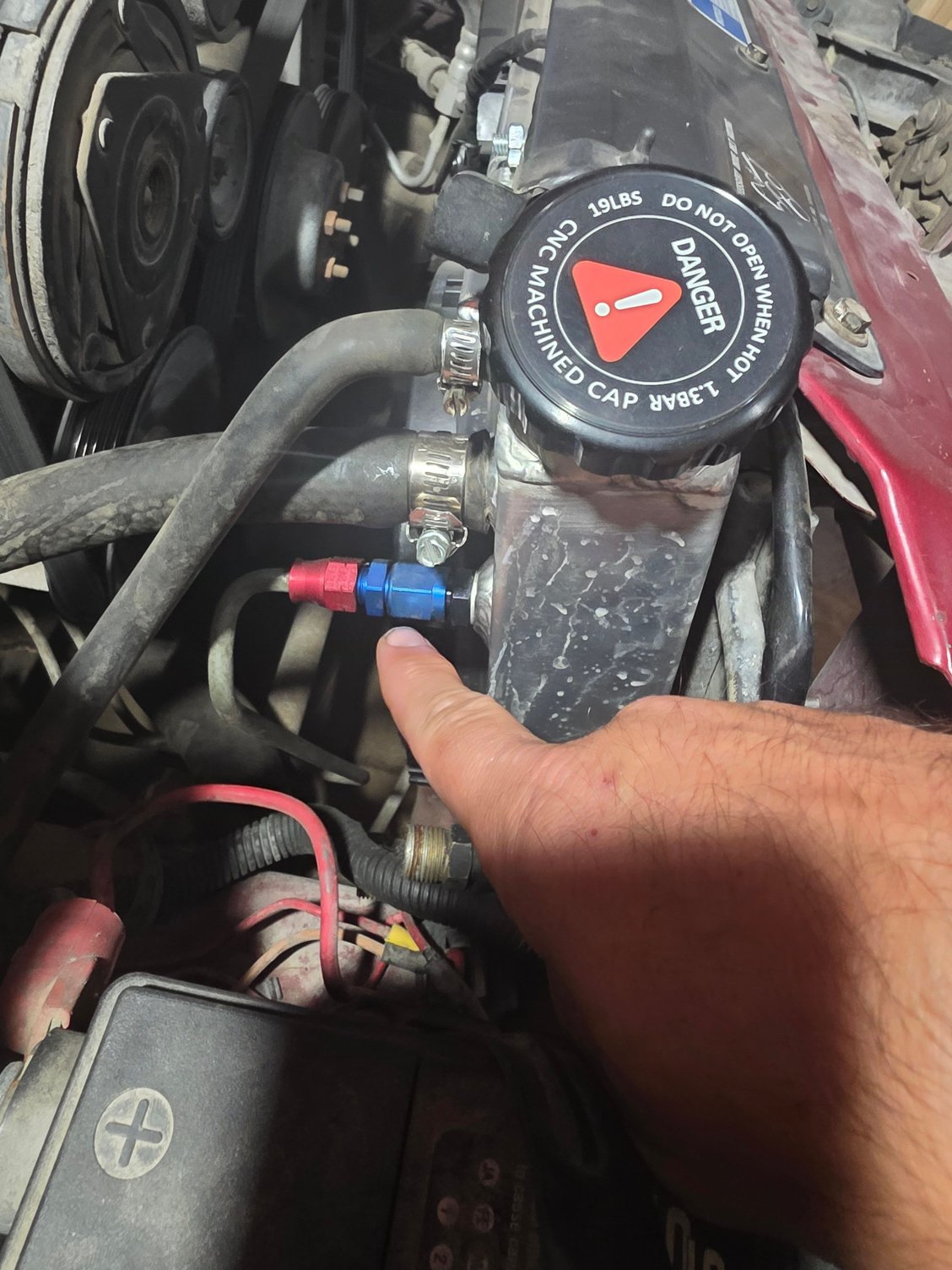

The kid had a 10lb rad cap. Not a 16, a friggin 10!!! Next, it was probably original, cheap, thin core, plastic tanks on tiny aluminum core, extreme heat, extreme cold, i live in north Dakota. I put on the factory 16. 80° day, blew both tanks off the radiator. Got the alloyworks for my camaro, as ive already got one on my 92 gmc k1500 350.
The transmission lines need an adaptor. Had to order mine. The only real modification was to the upper plastic radiator mount. Cut it to fit, this radiator holds a lot more fluid.

Next, change the engine temp sensor right next to the thermostat housing, check the pigtail. The rubber insulation was peeled back from the pigtail connector itself, 9.99 at oreillys or something. there, now my computer was getting the correct temp reading to balance air/fuel.
Still got hot according to my dash.

Engine temp sensor AND thermostat housing with extra ports.
Transmission line adaptor needed!

Some cutting is necessary to the top radiator shroud.
Its pretty hefty.
Its pretty hefty.
