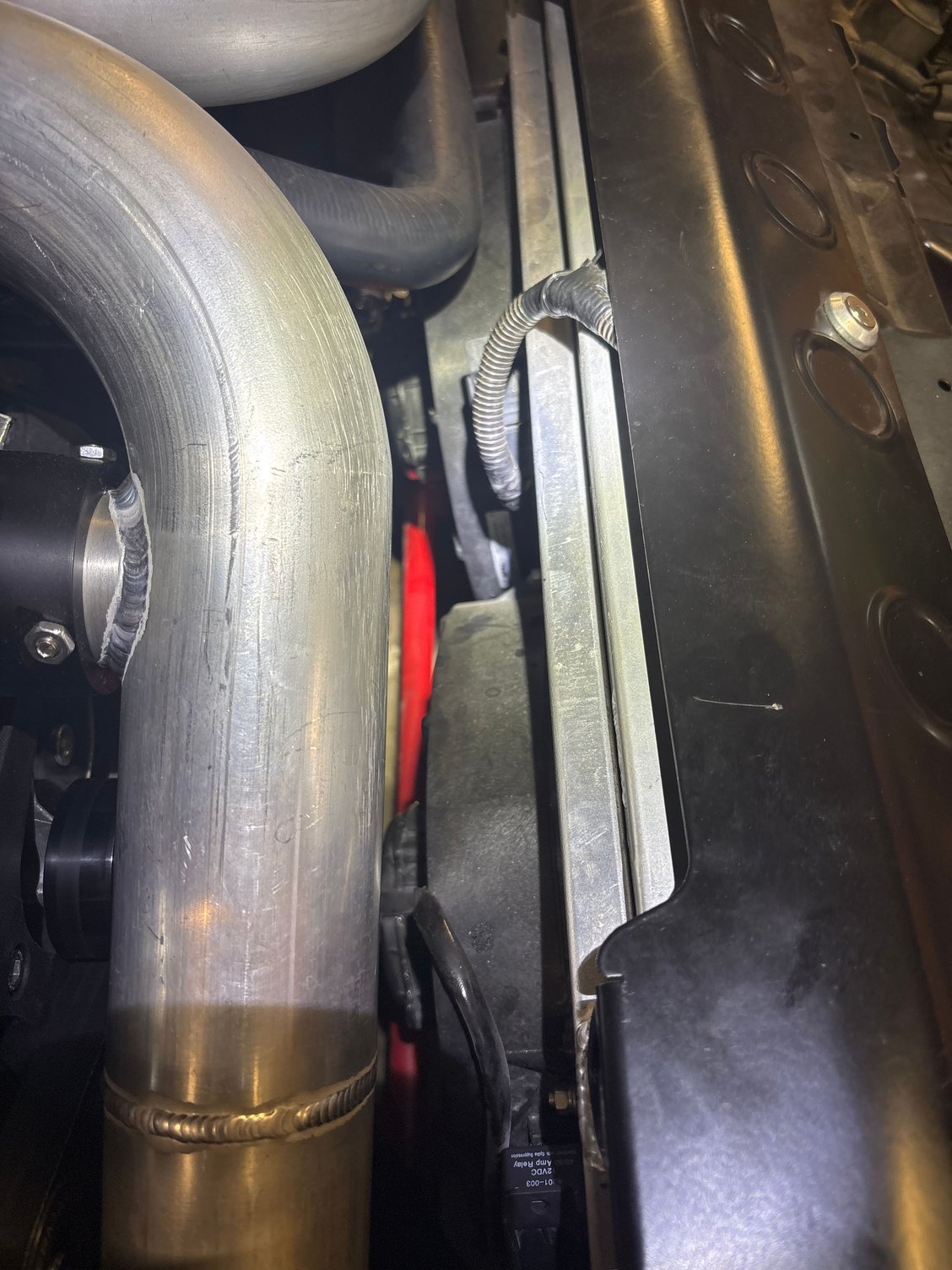

I had similar issues on my car. It's not a tpi car but the champion radiator fans were less than adequate. I swapped in 2 spal 30103202HO. They needed a wiring and relay upgrade to run but cool really well.
This pic is the old vs new
Reply 0
Jun 6, 2025 | 04:28 PM
Re: Aluminum fan shroud / TPI car
These are the spals installed. Plenty of room

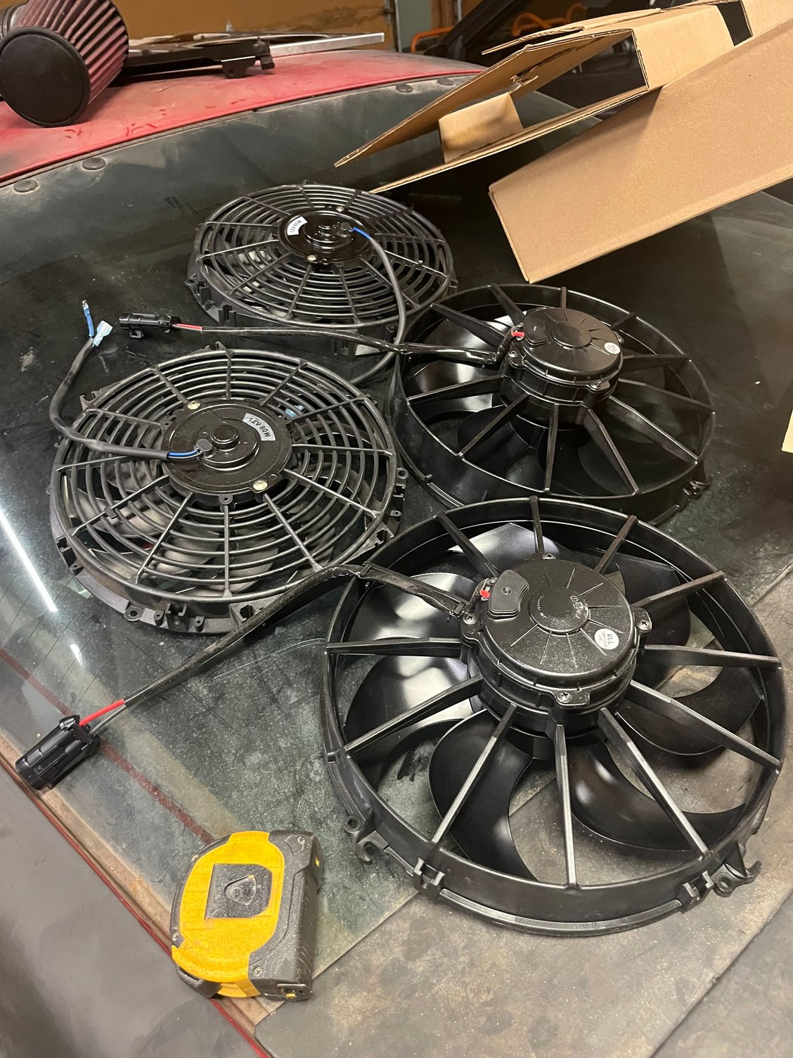

So I don't have one yet, just the stock fan setup. I do have one on my sport coupe but the front end is gutted and I just have the small chin spoiler so I get tons of airflow through the front of the car rather than from under. I also have some spal 1470 cfm fans, which... maybe... might... be a bit excessive, since with both running it'll pull down from 190f to 160f in about 1.5min. I do have the spal 800 cfm fans that were on there which I was planning on putting in the IROC if I get the shroud.

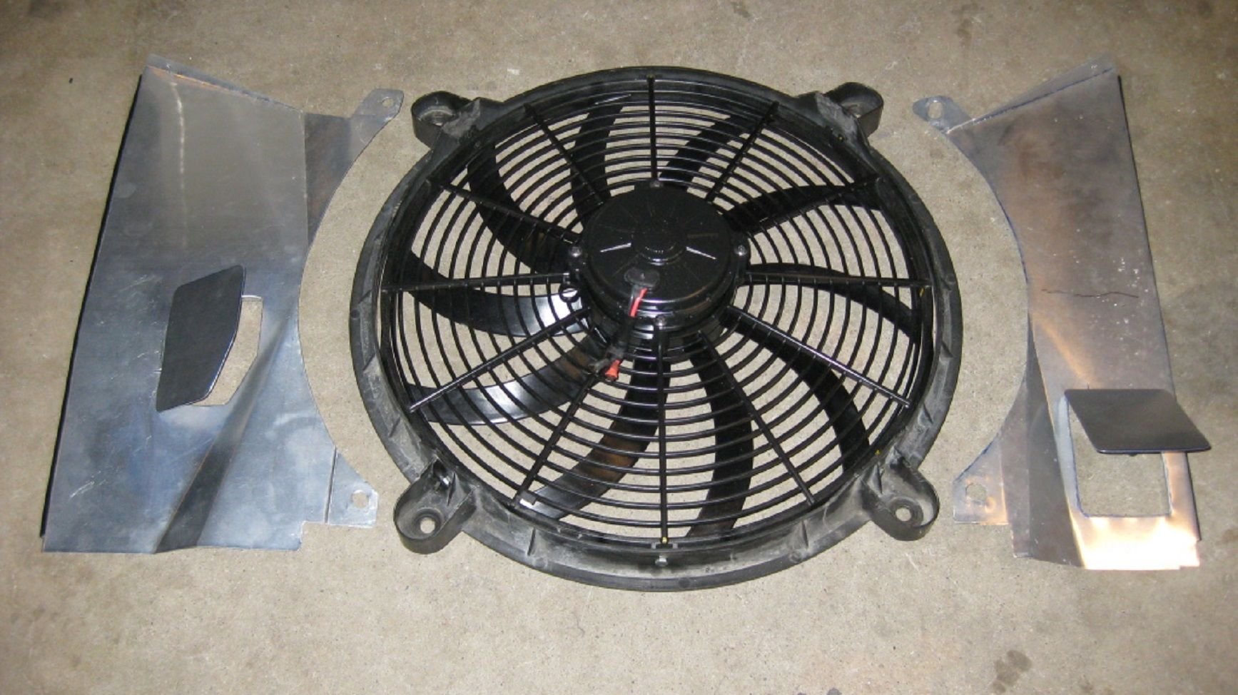

I made little spring loaded flaps that open around 40 mph. Doesn't over heat at all. That's a spal fan inside a gutted stock fan frame
